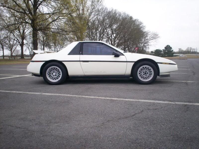

It may not help much, but this is a photo of my '88 Formula the day I got it. 151k miles on OEM springs and replacement shocks and struts. Camera is level. Notice the front in relation to the rear.
It did not bother me, as most every Fiero I've seen and driven has this stance.
Remember that with you having an '88 four cylinder model it will not have a rear anti-roll bar, so that will affect stance in relation to other cars when you work the suspension out. Additionally, what Blooz has pointed out above is very much correct and a consideration to take in when thinking about lowering. Obviously when you lower your supension you're only changing it's geometry. With a 1" drop on my '86 GT, I see about a 11 degree angle on the front nose, and on the rear it's right in between 21 and 22 degrees.
