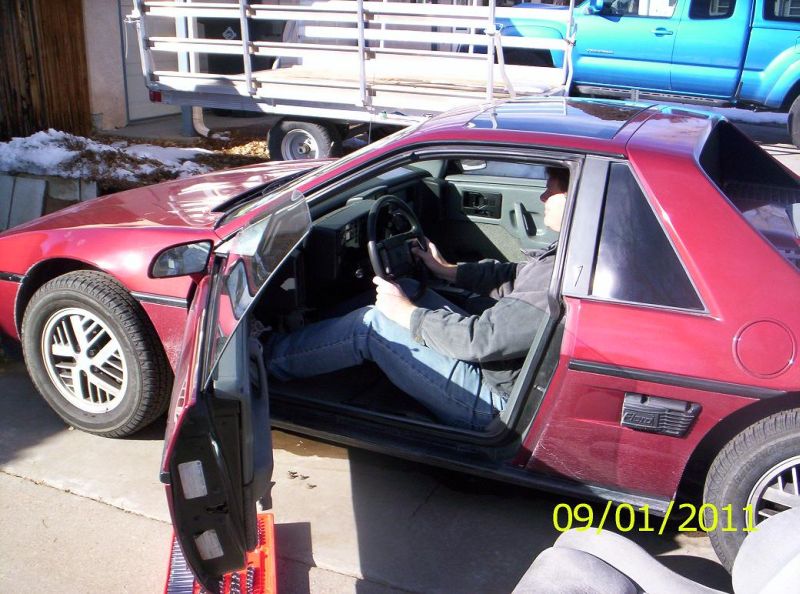

Just thought I'd start a thread about my project of making my Fiero tall-person friendly.
I recently bought Frizlefrak's '88 4.9L Coupe. Long story short (no pun intended), I don't fit very well, so I'm trying
various things. Here is the car with no driver seat:
Hey, who needs seats?! Sitting on the floor with back against the fire wall.
This gives me maybe 2 inches of leeway both headroom- and legroom-wise.

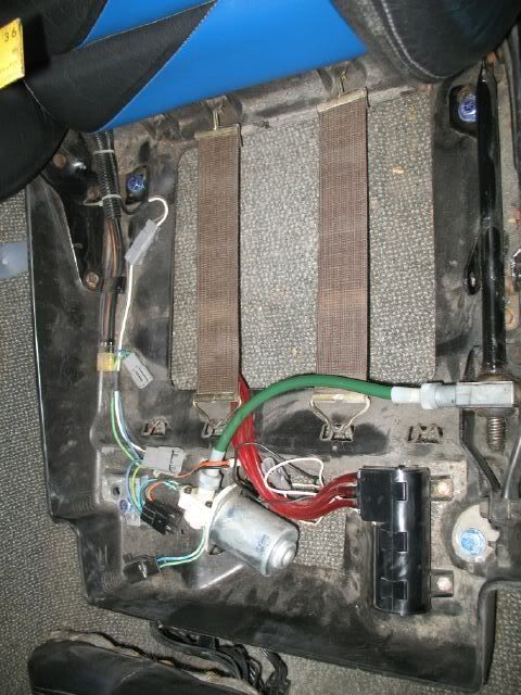

I was planning on removing the seat rails and making a bracket to basically bolt the seats directly to the floor (the bracket
was going to obviate the need to put holes in the floor...just use the studs that are already there).
However, it looks like my plan is a no go. I took the rails off the seat and put the seat directly on the floor to test things
out and the only gain is maybe a quarter inch (if that)...that's not good enough and certainly not worth the effort. You might
be asking, "How can that be?"
Glad you asked. See, in normal operation, when the seat is all the way back on the rails, the angle of the rails makes it so the
seat is already basically "on the floor". It might help to remove the rails for chop top cars with normal sized people because
the rails angle up as you go forward.
Just for kicks, I also tried removing the seat back and just sitting on the seat bottom (back against the firewall). That didn't work either.
That just pulled my head out of the sunroof zone and into the rear roof area which is lower. So, I'm going to have to either:

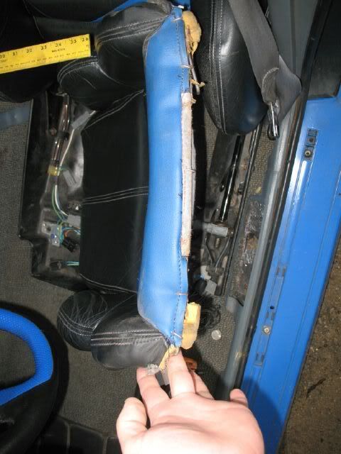

Try to find some seats and sit in them before you buy. I have racing seats in my Corvette and they are ok for short drives but anything more than a couple of hours and they get uncomfortable. They are also narrow, you probably will be ok as most of your issues are how tall you are but my racing seats are a snug fit.
I have no seat rails in my Vette, the seats are just sitting on the floor board. My seat belts keep me in place.

As you start to lower the seat, the seat back mechanism will hit the raised portion of the chassis (where the coolant tubes run) before the seat is fully lowered. So you end up needing to trim the bracket to clear. Also, the seat foam protrudes from the bottom quite a bit and will keep your seated position higher, so it needs to be trimmed as well.
I am 6-2, but wanted to setup my seats to accomodate a 3" chop and make sure I was comfortable with the driving postion before committing to the chop. Here are a couple of pics of the seat modifications I tried (and notice the bolts/nuts I used to adjust the elevations.
I ended up using the C4 vette seats. They can be mounted much lower and the seat cushion (and I use that term loosely) is very thin. Since the bottom seat pad is removable, you could make some simple sheet metal brackets to bolt to the existing studs and then bolt the seats to the brackets. For mine, I just bolted the seats through the floor with some 3/8 " bolts and some large fender washers on both sides.
Lay a ruler accross the center console and measure down to the cushion (these seat bottoms have much less foam and will compress even further)

Thanks, fieroguru. So if I'm seeing the tape measure picture correctly, it looks like a little over 11 inches from the top of the center console to the
seat bottom. Is that right?
I noticed the seat cushioning was pretty thick in the Fiero seats. I don't know how much I can gain by trimming it (and if that would make it
uncomfortable to sit in)

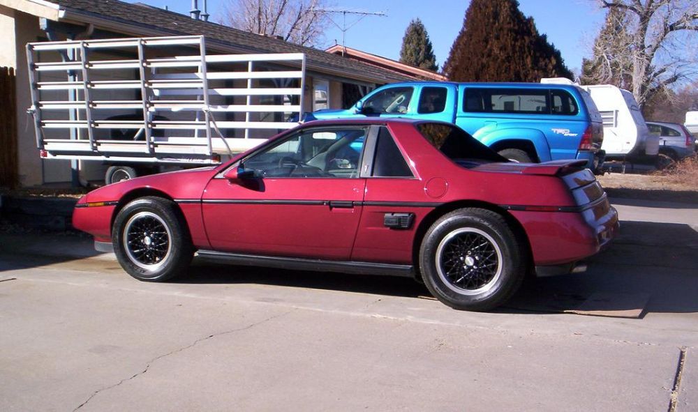

I haven't done anything with the seat stuff, but I did get the GT rims mounted to some tires and thought I'd post a pic:
The tires are 215/60/15 in front and 215/65/15 in back. The rear tires are 26.0" diameter and I like the way they fill the
wheel wells. They come closer to the stock 4.9L Deville tires (215/70/15... 26.85" diam), so my speedometer/odometer
is only fast by ~3% which is liveable. (E.g, when speedo says 75 mph, I'm really going 72.6 mph).
The front needs to be lowered about an inch to look best, but from what I've read here on Pennock's, it sounds like a big,
scary deal to lower the front. Maybe moving the battery to the front will weigh it down a bit...

88 Front lowering ball joints, drop it an inch without touching the springs. Fairly easy and quick swap, compared to installing lowering springs.
http://rodneydickman.com/ca...ndex.php?cPath=26_43
