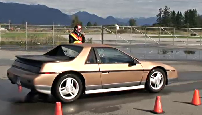

Okay, I just grabbed and cropped a frame of video from some autocross footage shot last fall. So this is how my '84 (with newer body panels) looks with two cut coils front and back...
[EDIT] I re-did the image above using a frame grab from the original AVI footage instead of from a re-encoded MP4 version of the video (which was earlier posted and copied below). Quite a bit sharper!

Originally posted by Patrick:
Okay, I just grabbed and cropped a frame of video from some autocross footage shot last fall. So this how my '84 (with newer body panels) looks with two cut coils front and back...
thats basically exactly what I want for the front so 2 it is then.. I was worried that might be a bit much.. but looks good to me

I'm going the extra mile tonight..
I dug these up. I was wrong, it seems we only cut 1-3/4 - 2 coils from my friends car. I have the photo evidence:
And this is how VERY low the car was afterward.
Here's what my coupe looks like with 1-1/4 coil cut. Perfect.

Originally posted by L67:
...two coils will be excessive. Remember that my friend's car was "slammed" with two coils removed.
Refer to my earlier post copied below. What you're saying is simply not true in every case.
Not all Fiero springs are the same length, so the number of coils to cut off will be different depending on the springs you have and how low you wish to go. I cut off two coils on the front and back of my '84, but the '84 sits higher than the other years with its stock springs.
I also posted a picture of my gold '84 above. It's not "slammed".
nice thanks for posting that. I'm so glad I didnt cut 2 coils
