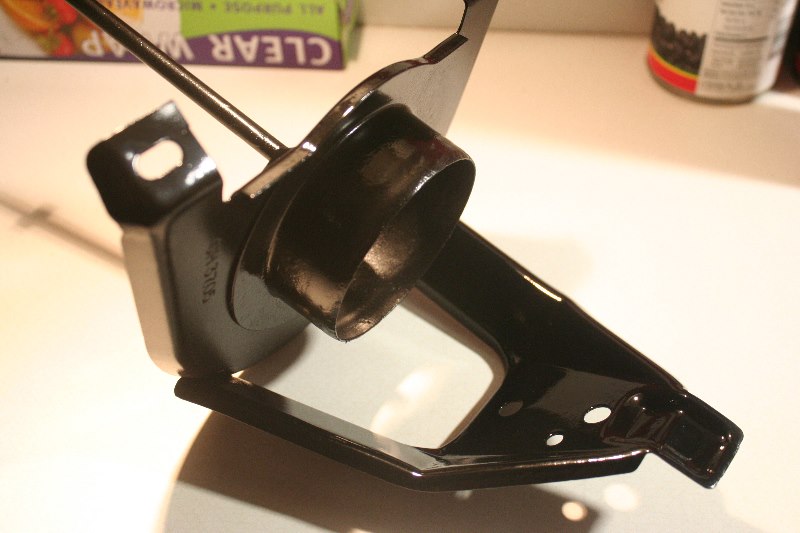

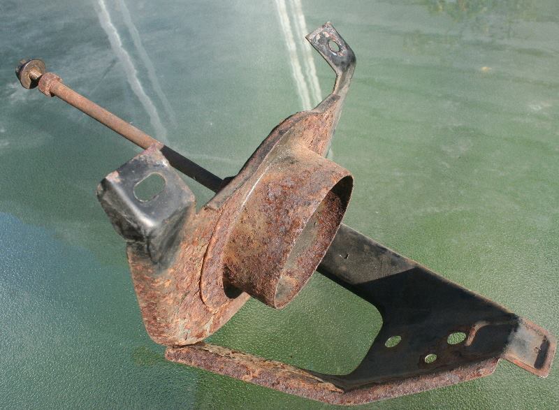

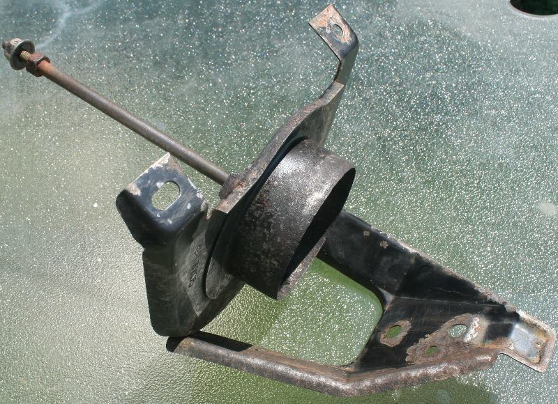

The electrolysis process works VERY well! I used a plastic bucket, filled it with enough water to cover the part, and stirred in a few table spoons of baking soda. I just used my cheapie old battery charger, and let it sit for a couple hours, and wow. When I took the part out, it was covered with sludge, I rinsed it under water and was amazed just how well it did.
This is the air canister bracket that I started with:
This is what it looked like after I took it out and rinsed it off, This is with no sanding or rubbing of any kind, just rinsed it off:
This is after a bit of sanding and a fresh coat of paint:
It will not perform miracles though If the rust is bad enough to pit the metal, those pits will remain. You can see some pitting in the air canister part above. The great part though, is when you are done there is zero rust, and painting it will prevent any further rust from bubbling up under the paint.

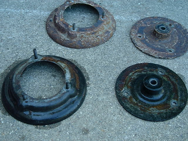

https://www.fiero.nl/forum/F.../HTML/078498.html#p4
Upper spring perch untouched...
Upper spring perch de-rusted (almost completely at that point, anyway)...
I use washing soda in the water (NOT baking soda).
It is 'mostly' line of sight, but not completely. I've de-rusted a few fully rusted parts without turning them around, it probably just took a little longer than it would have otherwise.
I also did this to my motorcycle's gas tank which was pretty bad inside. Worked AWESOME.
