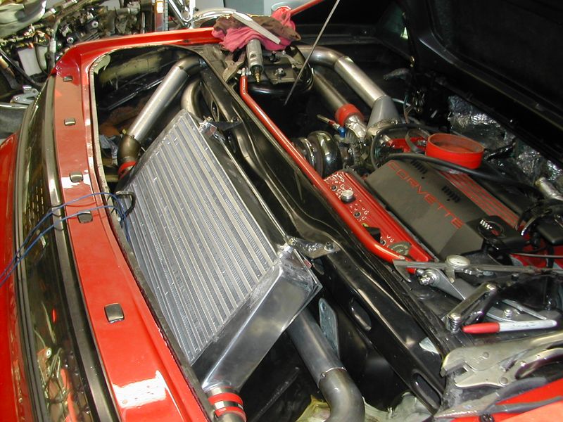

MotorTV
Posts: 260
From: chicago,il,usa
Registered: Nov 2001
Report this Post07-29-2010 12:43 PM Click Here to See the Profile for MotorTVClick Here to visit MotorTV's HomePageSend a Private Message to MotorTVDirect Link to This Post
Here are some shots of my setup...
This seems to be a good place for the turbo...
Unlike a low mounted turbo, it does not need a pump to return the oil to the oil pan..
Sorry for the wide shots... these pics were quick to find... from the build up on the piping...
Chuck

Great pics Motor TV. I love the intercooler. I have seen your setup before, I think you were at the 20th, or maybe just on here.

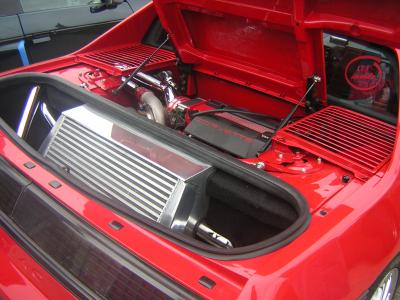

Justinbart
Posts: 3259
From: Flint, MI
Registered: Sep 2009
Total ratings: 119
Report this Post07-29-2010 02:07 PM Click Here to See the Profile for JustinbartSend a Private Message to JustinbartDirect Link to This Post
Rear mounted turbo....

^^^^^ Nice. Great photo. Thanks.
This has changed my mind on going with the stock iron manifolds. Maybe I could sell my headers and exhaust system and make back some of the coin it will take to do this. Now Im really thinking about it.
Rob

Its been a while since I posted this, but as I read through the thread i'm still amazed how my original point was missed. I used the STS system as an example, because of how its used in a traditional front engine, rear drive car. I agree with many who have posted that spending all that money on the STS system would be a waste, maybe I should have used a different tact. My idea was to take a stock 2.8 type setup, or a engine swap 3.4 DOHC, N/A 3800 type of setup and add a turbo. But instead of putting the turbo near the stock airbox (inside the engine compartment), but the turbo in the place of the muffler. My thought was keep the stock manifolds, stock Y pipe, stock (hi flow) cat converter (Smog Nazi's) but Turbo instead of muffler. Route the oil lines, BOV, and other parts needed. I was going to swap out my 88 rear fascia for a 87 so I could route the new exhaust pipe out to the one exhaust tip location. Maybe getting rid of the trunk or parts of it so you can get the Turbo in the best position, and to see it :-)
A few have done this as I see now, and the pictures above are basically what I was thinking. My number one goal of the system was to keep the traditional exhaust setup, not run the engine swap "short route" system (dump straight down, cut out the trunk). I agree that it may not have been the most efficient system, or make my car the fastest Fiero in the world, but I was looking for a fun drive, fun system, nice to look at type of car. Its not always about going fast.
Anyway its all OBE now, since I went and had Archie install a LS376.
I may do this with my next Fiero
Rob
