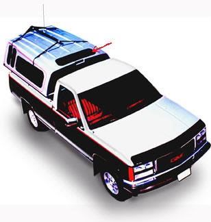

However... I must say the two 18" subs I helped my freind put in the bed of his Toyota 4X4 were most excellent to experience. To bad the enclosure took up his entire bed and popped the glass out of his camper shell when played.

Just to clarify. His camper shell was similair in style to the photo below and the window with the red arrow pointing at it is the window that popped out on his.
