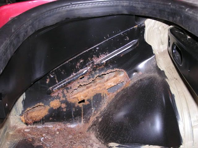

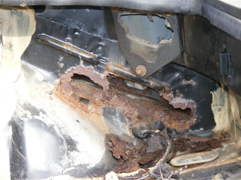

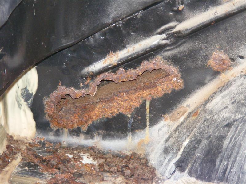

Hello, been a while since I posted. Well, today I was doing some trivial maintenance. I removed the fan from the trunk, and all the tubing. Oddly enough it works? but it never has on the car. I'll do a search to find the info for the methods used to fill the voids left from this mod.
Anyway my absolute worst fear has hit home. I was afraid it would be the case as, the rubber seal leaks, and the trunk had been getting damp... I pulled the carpet, and found huge rust holes in the sides of the trunk. Besides only minor surface rust on the usual places there is none this bad anywhere else. Should I look deeper? Like pull the rear fascia off, and see if it has rusted else where? Or, have I caught it soon enough to be able to stop it's progression? Any help on this matter is GREATLY appreciated.
{Fixed pic's} Don't know how I messed them up

Everyone up north wishes their car looked that good.
You could just leave it alone. You could patch it.
Too far gone? That is always a totally subjective question. It's always up to you. You could rebuild your Fiero starting with the ignition key. You won't ever stop a car from rusting, but you can slow it down.
So it's up to you. If you wish to invest in the time to 'make it right' you can. You can also leave it alone.

check other area's like where your lower control arms attach to the cradle, more of a concern.

Yes be concerned. There is good cause to suspect your frame rails are infected and perhaps weakened.
This needs to have the area exposed and repaired. Rubyredfiero makes replacement frame rails if they are in fact rotten. You need to cut out the infected metal and weld in new. This is not an easy quick fix. You will likely have to remove the rear clip and do major surgery.
Sorry to give you the bad news. I don't think I'd drive it without stripping it down and making sure the frame is solid.

From my experience, you have caught it soon enough to save a lot of the original metal. Fix it now, as it will worsen rapidly. You need to remove the rear clip and fender liners to properly assess the damage. It can be repaired, but do it now.

Fix the leaks, cut the metal out and weld new stuff in. It's not that bad.

This being the only car I have ever owned for more than a couple of years. It pained me to find the problem. However, the good news may be in the fact that the cradle and areas closest to it are fine. It has just been a little over a year since it got a physical at the Fiero factory. It was in for a clutch they looked it over in the major areas visible without taking things off. It looked ok, not great, or showroom perfect but passible.
This will be a salvage operation I have had this car to long to give up on it. I have had cars come and go but, this one I have never even thought about selling. Of course the only times someone offered to buy it I was offended by the lowballing offers. I had to literally chew, not bite but, chew my tongue to keep from going off...
So, metal work it will be. I wanted the opinion of the forum on it. As I know alot of you have seen this type of damage, and have dealt with it. I have seen quite a few threads with pics of much worse unfortunately a few of those cars became parts donors.

I took the splash shield off and wire wheeled that entire area, then sprayed on some zinc primer. if you want you could weld in a patch, but wire wheeling followed by paint should keep it from spreading anyway. I also like 3M professional undercoating

When I perform this type of rust repair, I have Jeremy at the Fiero Factory cut out good metal from a Fiero and ship it to me.
I then drill out the factory spot welds, remove the rusted pieces, and weld in the pieces that I get from the donor. I can usually cut the upper frame rail aft of the forwardmost body mount pad, take out the formed trunk corner at the factory seams, the aft end of the structure at the rear crossmember, and put in the repair piece as one structure. Weld in the drilled out spot welds, paint and seam-seal, and it is impossible to tell it was ever rusted or repaired.
It takes some trimming, cutting, clamping, measuring (several times) and welding, but the end result should be as solid as the original structure, and react properly in case of a collision.
Good luck - get on it and do it right! It needs new metal at this point, as it has spread to areas you can't see or get to easily.

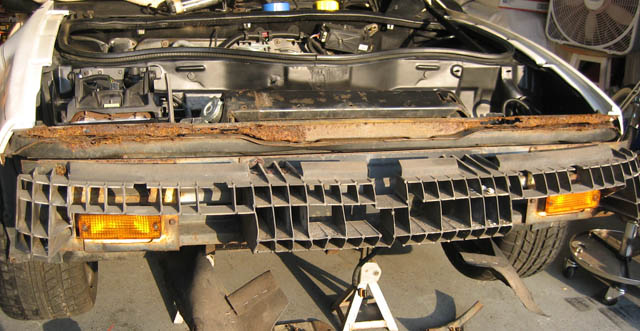

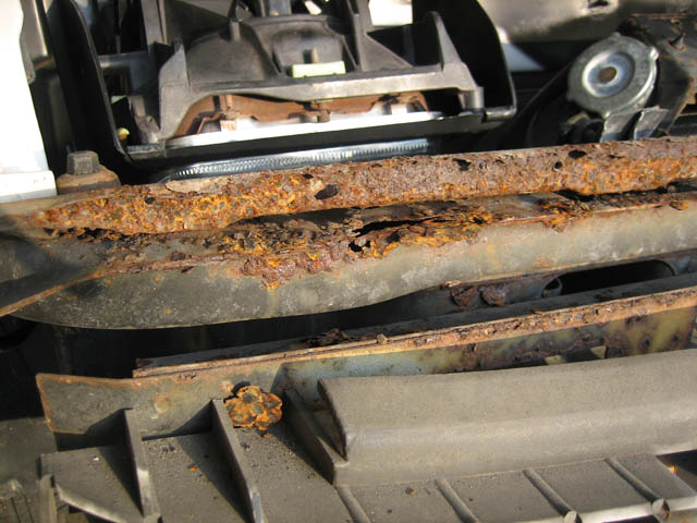

If the rear is like that I strongly suggest you to also take a look at the front before it is too late. This car has a perfect trunk but this is what I found when I went to restore a little the black frame that is seen between the front bumper and hood. What a big surprise
