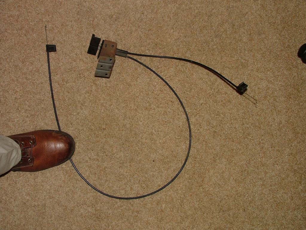

This is what operates the vents. It is located below the gauge pod on the right side.
There are two cables. One long one for the passenger side and a shorter one for the drivers side.

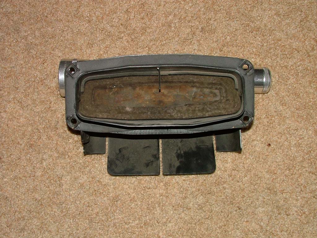

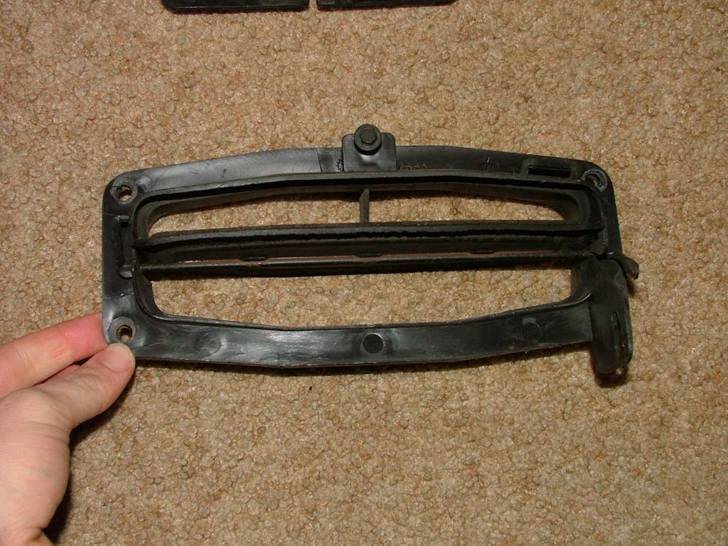

This is one of the vents showing the side which mounts to the chassis
This is the other vent with the "deflector" removed to show how it opens up to let air through

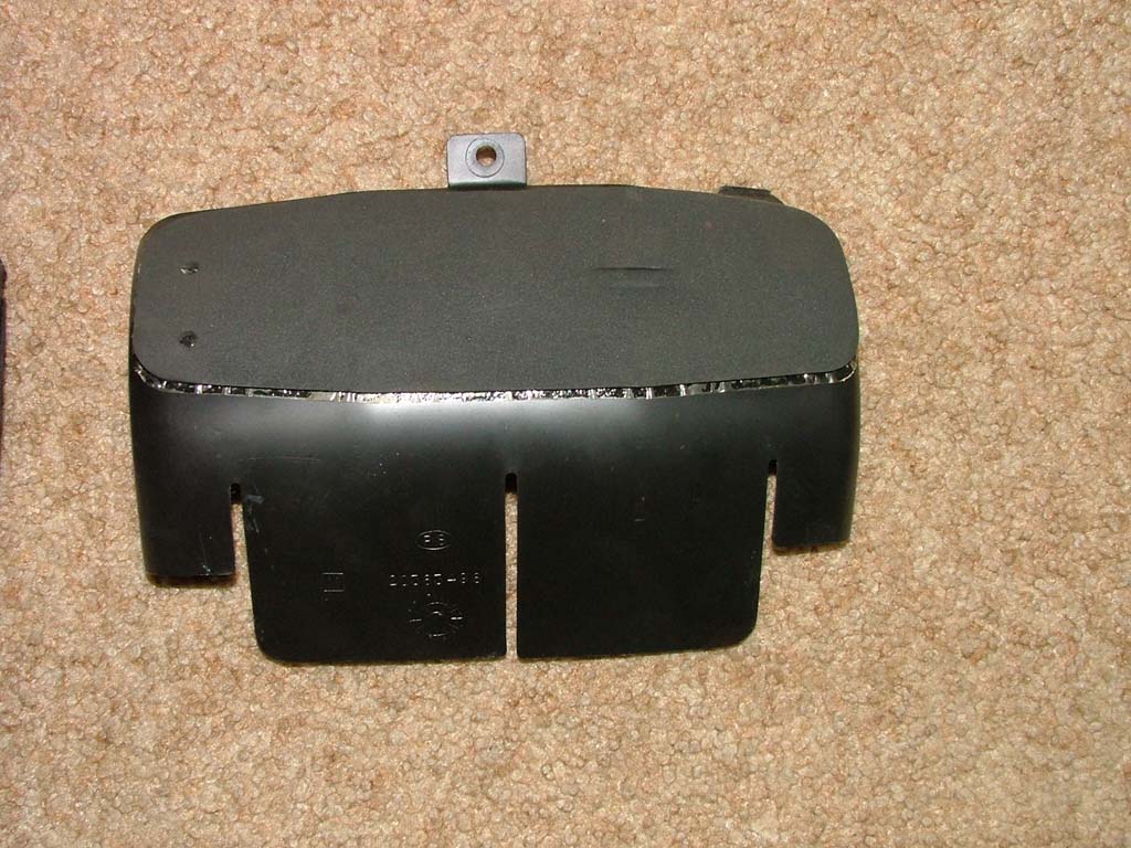

This is simply the "deflector." I really don't know what to call it I named it the deflector because it looks like it is supposed to deflect the air down towards your feet.

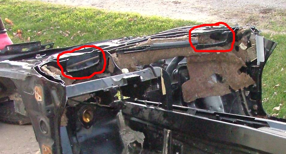

Then this is the best picture I could come up with showing where they mount to the chassis. This was my parts cars and as you can see I cut off the windshield and I actually cut off the top portion of the holes where the vents go. The holes are really close to the bottom of the windshield and allow the vents to draw air from the front cowl area where the windshield wiper linkage is.
