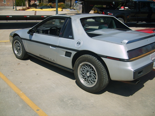

I put the glass sails on a set of 86 frames the same as you would do to put new plastic sails on. It looked good to me. They are about 1/4" or so smaller all the way around. I was real careful on matching them up to the frames and trying to get them centered up perfect. I used the double sided tape recommended on Fiero Sails web site. They have been on the car since 2007
This is the best picture I can find. 2008 Spring Fling
Dec 2008
