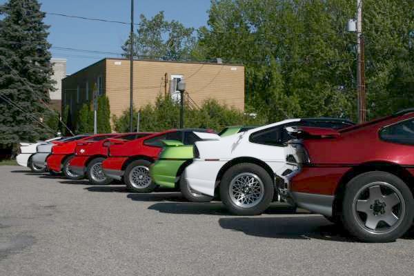

Mine was originally an '86SE

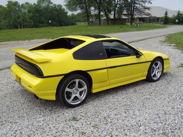

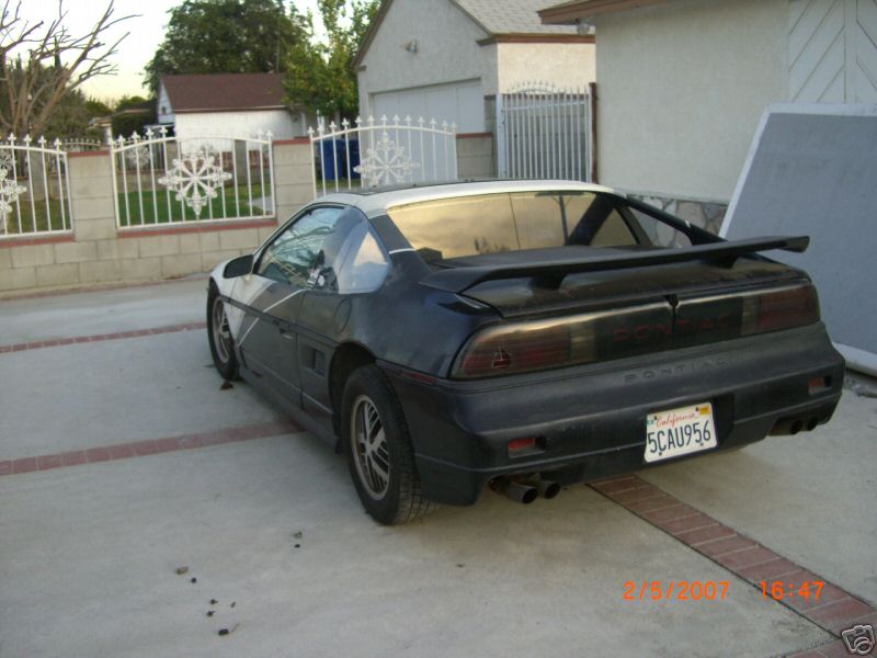

Before and after. 85GT + 87 fastback rear end. I kept the ribbed molding, notchback wing stands, and bumpers. The notchie wing stands made it easy to move the wing back ~2". Pure luck on the parts find. Got the entire setup at the junk yard including decent condition tail lights for 150 dollars.
[This message has been edited by Fieroseverywhere (edited 07-08-2010).]

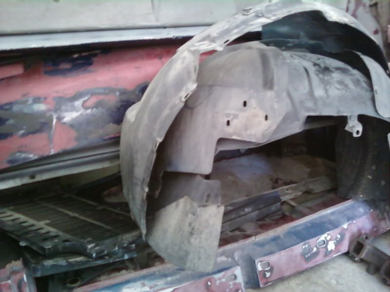

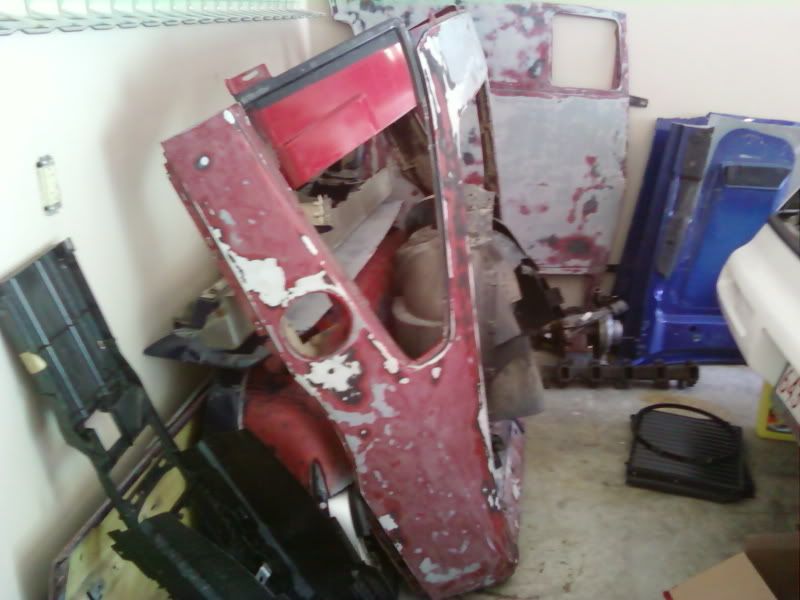

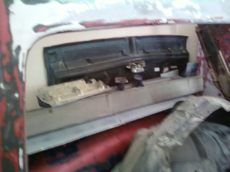

I went and took a few pictures of the parts I have waiting around to show what is involved in a complete fastback swap if you do not have an aero fastback.
Below is the 'clip' itself. That's the large piece that is what makes a 'fastback' a fastback. Everything you see sitting under the clip is everything needed to swap a non-aero notchback to an aero fastback, minus taillights and harness
Here's a close-up of some of the misc pieces. You have to have the fastback engine covers, and all the pieces that hold them onto the car. There's also the aero bumper bracket (needed if you don't have an aero bumper), wheel liners (also needed on non-aero cars).
Here is the ground effects, fastback decklid (against the wall), the spoiler (the grey piece sitting on top of the front fascia and below the ground effects) and underneath that all is the rest of the pieces and a rear aero fascia.
All of these parts car run in the ballpark of anywhere between $200 - $1,000 depending on how lucky you are. Remember I still don't have the OEM lights or the quarter windows yet, meaning I'm likely going to at the least be out another $200-$300 for some good taillights and at least $170 for a good set of aftermarket quarter windows. This is why many members will tell you it's best to just go ahead and buy a fastback. I already have a '86 GT fastback. I just wanted to have my Formula looking like it too.

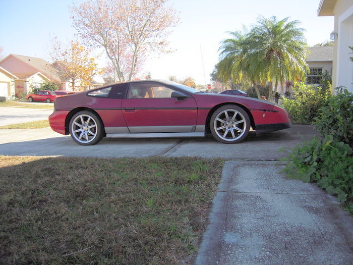

Here's mine and IwannaIRM's.
https://www.fiero.nl/forum/A...060811-1-057773.html
Mine started life as a Formula. All that was swapped from the fastback were the rear body clip, trunklid and tail lights (and a few hidden bits and pieces.)
I also added the Fiero Warehouse side scoops and whale tail, but all the rest of the body panels, including the front and rear bumpers, are stock Formula.

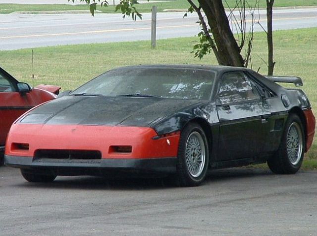

Here's a fastback Indy that was done over a decade ago
My car started life as a coupe, (notchback). I did the conversion myself, then had it chopped.
Honestly there is no obvious way to tell a fastback conversion from one that came from the factory fastback because all the same parts are used. The VIN will be a dead giveaway though.

From this.
To this.
