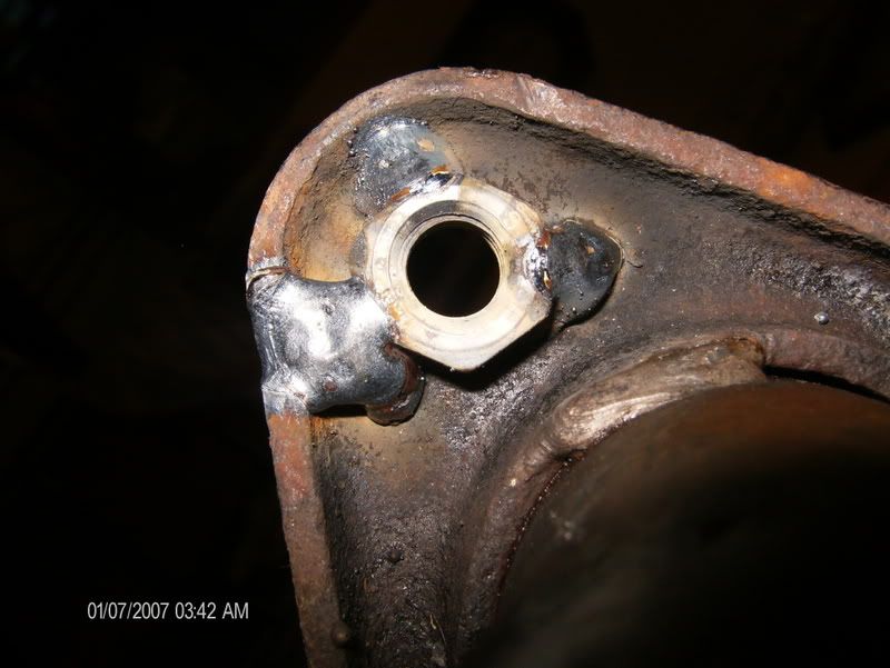

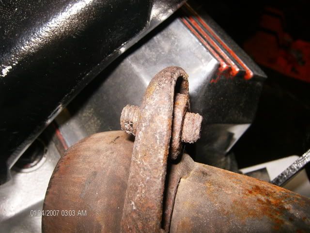

4 days!!!! Ive been fighting with this broken bolt for 4 days. Hence no updates on my build thread. Its the bolt that connects the manifold to the y pipe. I figure easy enough, just drill it out and re tap the hole, no problem. This bolt is made of something that is not from this earth! It melted the tips of my titanium drill bits and has managed to ruin every bit in my box. So i went to home depot and bought some cobalt bits for 50 bucks . Put it in the drill press and started to drill. Made it about a 16th on an inch down and the tip of the bit starts glowing. But it made a little hole so i tried to stick a ez out and pull out the broken bolt. I get my hammer and tap tap tap tap SNAP! At this point im pissed. I throw the manifold across the garage and came in the house where I sit now. stupid bolt. I need ideas! I was going to take my cutoff wheel to the welds on the nut itself, I cant find my friggen cut off wheel. Ideas please.
Rolling Thunder
Posts: 1244
From: College Station, TX
Registered: Aug 2008
Report this Post05-28-2010 11:31 PM Click Here to See the Profile for Rolling ThunderSend a Private Message to Rolling ThunderDirect Link to This Post
Originally posted by 87antuzzi: I need ideas! I was going to take my cutoff wheel to the welds on the nut itself, I cant find my friggen cut off wheel. Ideas please.
Go buy another cutoff wheel.
Seriously, you shouldn't let a drill bit get that hot. Make sure it is well oiled. Lubrication will reduce wear and keep temps down.

I found the manifold. Ive used lube to help cool the bit. It still turned the tip red. Im going to cut the tack welds on the nut off and re weld a new nut on.

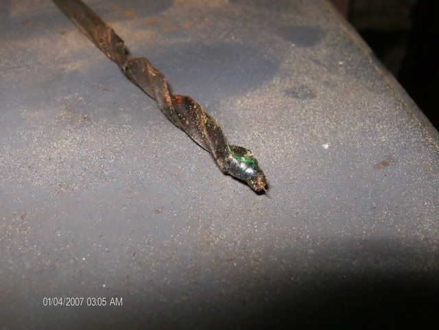

87antuzzi
11151 posts
Member since Feb 2009
here is a pic of the low end bit i was using. Melted it
the bolt itself

Antuzzi.... Cut the nut in half with your cut off wheel, then use a punch to get the rest of the bolt out. Stubborn exaust shat. Good luck man...
the bolt itself
What a fight. You should of got some of this http://www.kanolabs.com/google/
Spray it on. Go eat a ham sandwich. Come back and twist it out with 2 fingers. No snake oil either.
