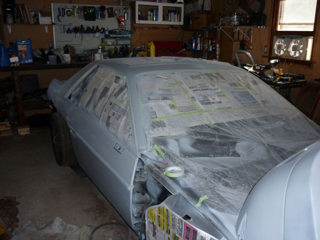

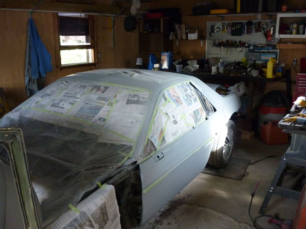

Report this Post05-30-2010 05:40 PM Click Here to See the Profile for bonaduceSend a Private Message to bonaduceDirect Link to This Post
just an update of the progress made today, took longer to tape than expected but nice to see car all one color again.
now to sand, and get reay for final color next week.
dan

Report this Post05-30-2010 06:41 PM Click Here to See the Profile for FirefoxSend a Private Message to FirefoxDirect Link to This Post
I'm hoping that you are going to remask the car when you are finished with the primer. Using newspaper as masking paper will give you all kinds of problems. Newsprint is made up of very small fibers and when you spray your primer/paint you end up getting those fibers in the air and all over your fresh paint. With primer it isn't a big deal as you are going to be sanding everything anyway but when you paint that newspaper will really mess up your paint job. You need masking paper designed for automotive painting that you can get from your paint shop.
