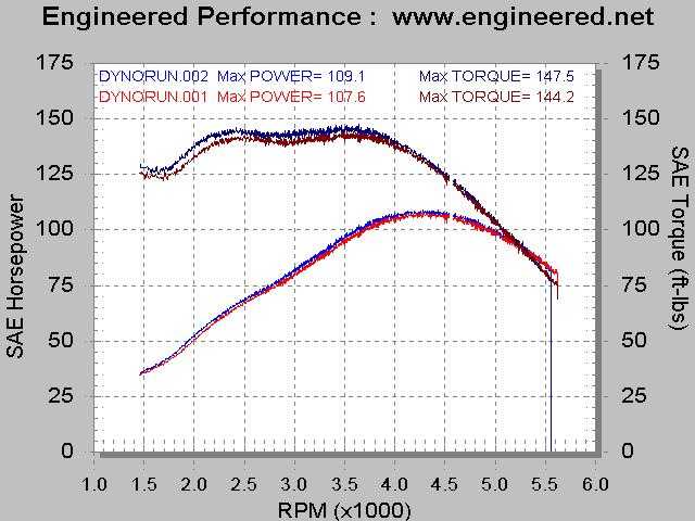

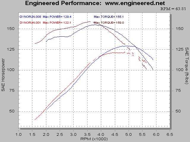

Back in the early 2000's a member here who worked at a dyno shop in Georgia, 1FST2M6, did dyno testing on the stock ported, Sprints, WCF exhaust, and the FOCOA exhaust.
The engines used was totally stock. The ported stock exhaust gained about 2hp, Sprints/WCF shorty's was 6hp, the full headers (WCF and FOCOA) both gained about 7.5hp but the torque curve changed slightly reducing upper rpm torque.
Here is the dyno run of stock vs. stock ported exhaust manifolds: (2.8L/auto trans)
Here is the FOCOA full headers vs. stock: (2.8L/5-spd manual)
