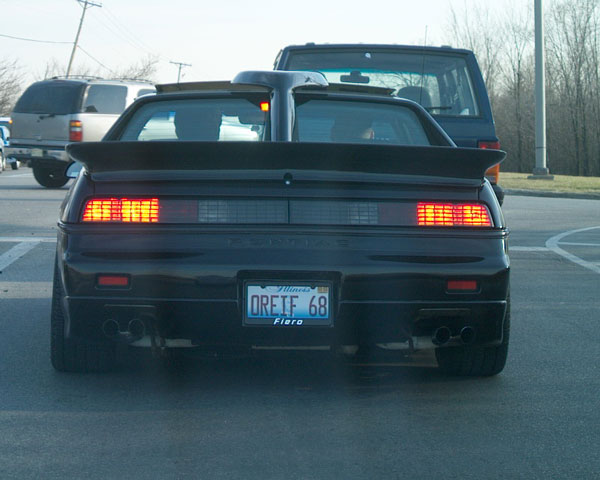

I bought mine from Doug at Fiero Warehouse. www.fierowarehouse.com
18th item down on this list: http://www.ovis.net/~dmkfiero/fiberglassparts.html
The quality is excellent from them.
From the website:
WRAP AROUND REAR SPOILER:
The Wrap Around Rear Spoiler is constructed of fiberglass and designed to provide an attractive and functional addition to any Fiero, except 1986 thru 1988 Fastback bodies. The spoiler fits directly on the stock Fiero rear deck and provides aerodynamic down force on the rear of the car at high speeds. This results in improved traction and handling stability. $400
Here are pics of mine:
Here's one when I had the Indy Scoop:
Mine is bolted on and I used some small rubber pads about 1/16" thick at the mounting points. The reason for this is to leave a small gap so water doesn't pool on the decklid. Some folks have had them glassed in, but pooling water can be an issue.
I did the same and would suggest the same.
