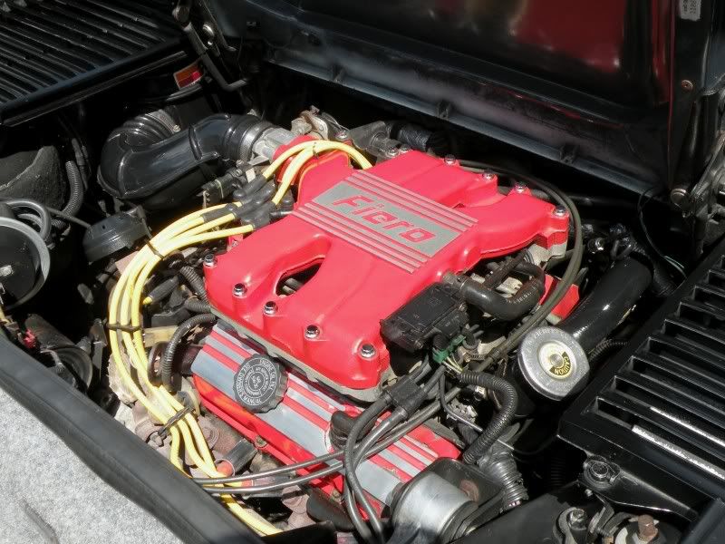

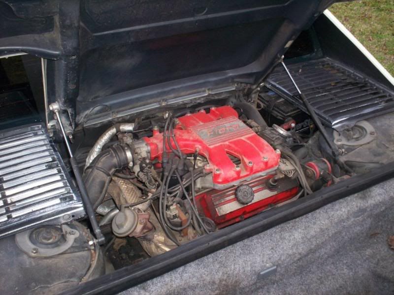

I have seen some stunningly clean engines/bays out there with high miles so I know someone has some secrets...comon and share them! Inspiring and inquiring minds want to know! How do you get all the crap off of there and leave a spotless engine...say you start with this...
(Not poking fun of the owner of this car/engine, just quickest I could grab. No Fieros were hurt or injured during the photographing of thi sengine.)

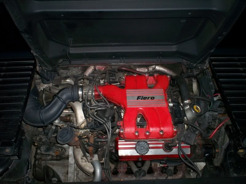

this took many hours sorry quality poor

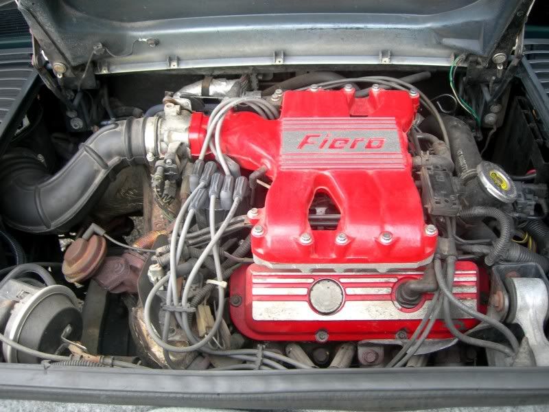

Here's my 270k mile '86 GT daily driver
And my 157k mile '88 Formula right when I bought it....
and after I got it.
I use paint thinner and brake cleaner. Typically these will damage painted surfaces but on most Fieros everything has been caked on by heat so it's not going to remove paint. What I do first is spray everything really good with brake clean. Typically I go through two cans cleaning the engine and the trans. Then with paint thinner on an old rag I scrub all the heavy stuff down. For all the black areas I get some high temp black paint and spray it to clean it up. It's not really correct but I like how it looks. Then on the things like the rubber intake and other pieces I hit it with some tire shine.
There's probably better ways to do it, but this is the cheapest way for me.

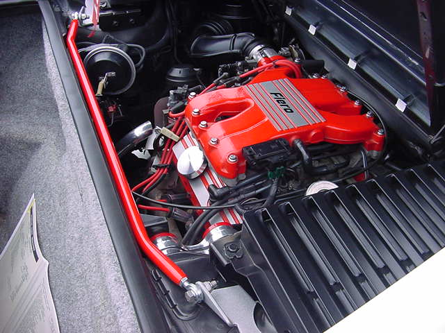

Here is my engine No repainting other than the exhaust manifold.
It was never dirtier than this even when I drove it in the winter. I just have maintained it for 25 years. Yes I do not drive it as much now as in the 80's but I used to wash the car several times a week in the winter when had to drive it in the snow. I also had it under coated and have since cleaned it off much of the bottom and now I can wax the pan.
I will second the 303 spray as it does work but I also use Armor all on some parts and on the wheel wells. The 303 is the only thing to use inside as it is not greasy.
I also use aluminum wheel cleaner on the trans axle and a tooth brush.
Before I forget a light fog of black header paint cleans up and refeshes the black insulation if it get white and faded looking. Don't coat it heavy just a lite spray.

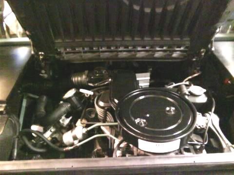

This is a 108,000 mile car. I was lucky...it was fairly clean already when I bought it. That was one of the reasons I bought it in the first place. But I've done a lot of cleaning on it since then. It's as others have said...there are no quick fixes. You can powerwash it and then spray it with Armor All, and it will look good, for a while. And, both of those...the powerwashing and the Armor All, or other protectant, are vital steps in a clean engine compartment. But what you also need to do is spend many, many hours in the trunk, hunched over the engine with a rag wetted down with degreaser, or a box full of Q-tips, to clean dirt and grease out of the tiny crevasses you find all over the engine compartment. Different people use different things to accomplish the same result...one person may use Armor All on a part, another might use something else. The best thing to do is ask...go to a show, and ask people how they cleaned their engines, what products they used, etc. You'l find that most people....especially at smaller, outdoor car shows, are more than willing to help you out.
These are of my car. I spent a lot of time initially, getting it to this point. Now, all it takes is a little maintenance every now and again to keep it this way. There are still a few things I'm not happy with...the worn heat blankets on the shift cables, and the rusty base of the EGR Valve. But, eventually, I'll get around to those. The main thing is cleanliness. Once it's clean, the other things aren't that hard to take care of.

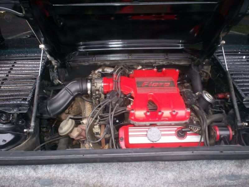

Just want to do a "side by side" engine comparision.
Before:
Present:
I like it!!
