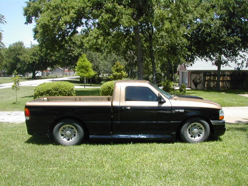

Yep, there are many ways and we all have a different style. This is my Ford Ranger I did a four inch chop on it and it uses the oem windshield and side windows. I only had to have a back glass made for it. I have been trying to talk my wife into letting me chop her 09 GT Vibe but she thinks not she likes the more room it has as is. Maybe latter, when she gets tiered of it.

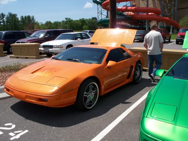

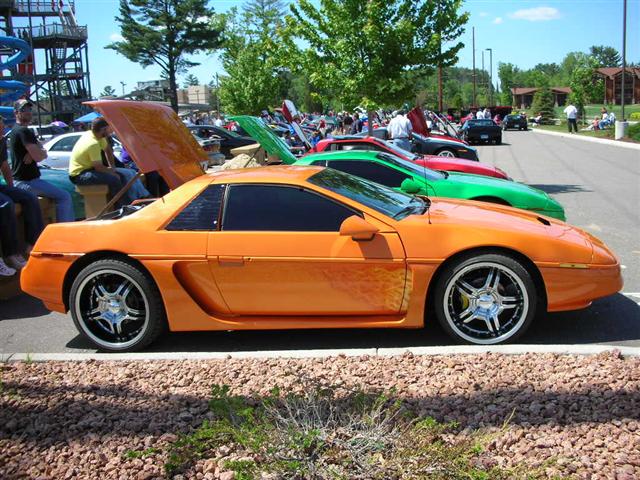

joshua riedl
1426 posts
Member since Jan 2004
Here's one that's not on the forum yet.

Report this Post12-28-2009 06:19 PM Click Here to See the Profile for infinitewillSend a Private Message to infinitewillDirect Link to This Post
Originally posted by joshua riedl:
I did use your windows and the fit is good. better that the last chop. I did have to shim the seal behind the quarter glass again but it's hidden. I just got a new computer and now need a usb for my iphone or have to buy a camera. the best I can do right now is find some pictures already on the forum. Actually if you pm me your email address I can send you what I have.
I'm confused here. Are you saying the the 2" chop you did is using OEM side glass? BTW, both of your cars look great! I have always loved the look of the chop top but for my personal taste 3" was too much. The 2" you did looks to me to be perfect given the mods I have planned.

Report this Post12-28-2009 06:24 PM Click Here to See the Profile for joshua riedlSend a Private Message to joshua riedlDirect Link to This Post
They are not oem. They are the windows 355 had made for fiero chops.

The cars look great. So aggressive looking and still say Fiero.
It's "tweaked"... that's what I like. It's good to be different.
mptighe
Posts: 3321
From: Houston, TX
Registered: Aug 2009
Total ratings: 122
Report this Post12-30-2009 04:01 PM Click Here to See the Profile for mptigheSend a Private Message to mptigheDirect Link to This Post
Fiero...now made by Crayola. Awesome looking cars man, and people definitely see you coming!
