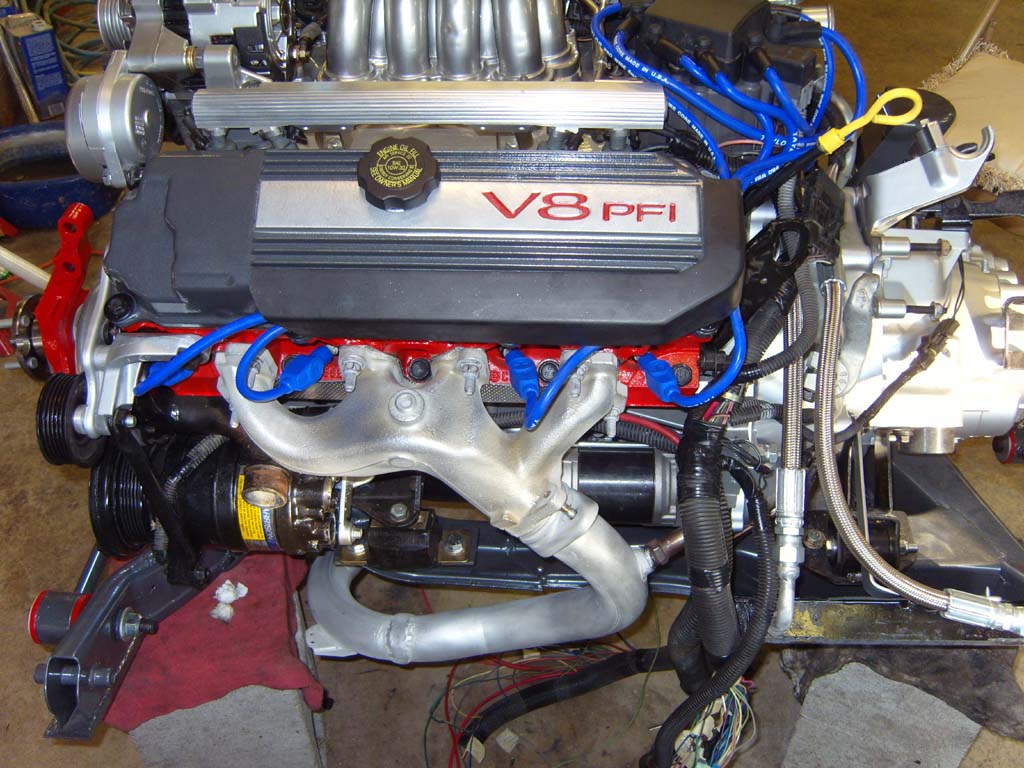

Here is a good estimate of what I have spent so far. I am not thtrew yet either. Chewap and 'Swap' do not belong in the same sentance.
And my swap thread:
https://www.fiero.nl/forum/F...1/HTML/077299-7.html
