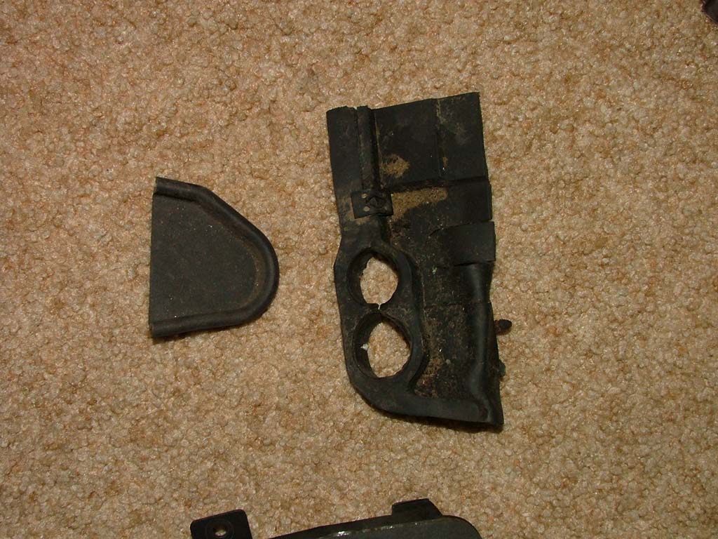

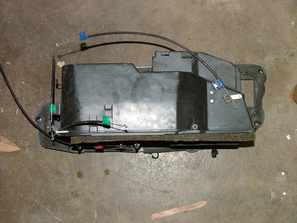

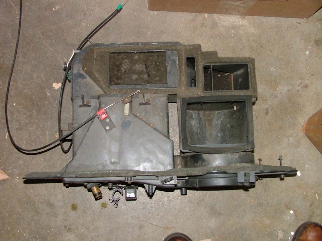

Ok, here are the pictures. First the "Air Box" that houses the Fan, heater core, and mixing flaps. Notice that it is all cable controled. It also does not protrude as far into the passenger or front compartment as the A/C equipt unit.

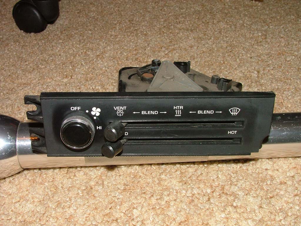

Then this is what controls all the cables.

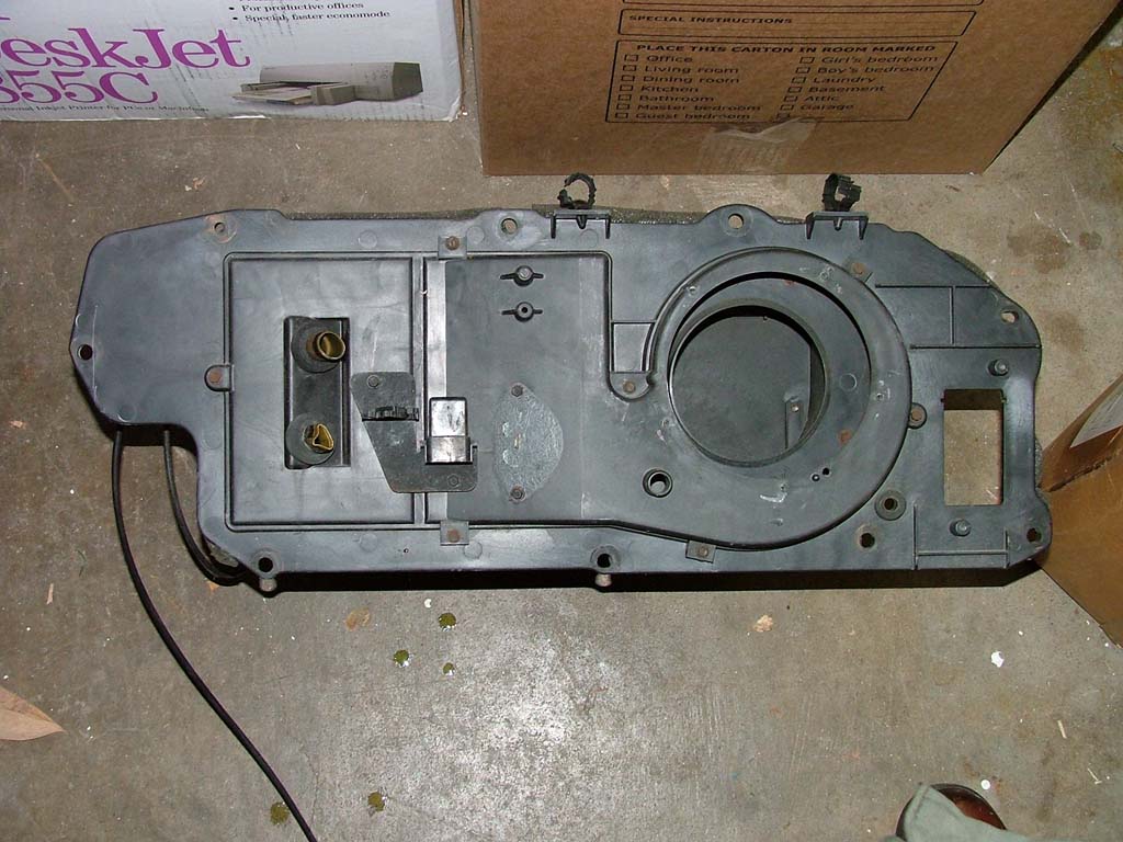

Then these are the plugs which fill the holes in the spare tire tub where the A/C hoses used to go. There is still a place for the heater lines in the one but the other is simply a plug.
