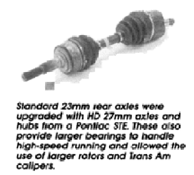

Report this Post10-31-2009 12:13 AM Click Here to See the Profile for California KidSend a Private Message to California KidDirect Link to This Post
I don't have all the details, but here's the axles used on the Pontiac Fiero Race Cars:
Hope it readable, I haven't looked into going this route yet, as it requires some other modification. Keep in mind that those race cars had a lot less HP / Torque than you're planning on.
[This message has been edited by California Kid (edited 10-31-2009).]
