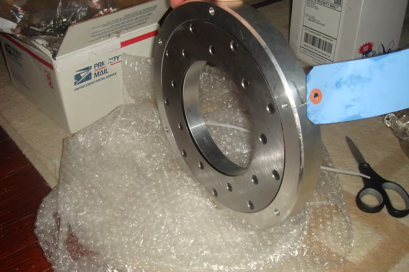

What's this about a large spacer and longgg bolts? Are you telling me that I have longggg bolts and a spacer?
Spacer:
Spacer installed:
Sure it works but......

what the hell did you use that with a flex plate or a standard fly wheel and how much further back is needed 1/2 inch 1 inch more than a getrag

I didn't use any of this--These are pictures from a guy that installed a 6 speed in a Grand Am using that V-8 guy's kit. The GA guy could have used another method that would not have used that large spacer/longer bolts but I guess he did not do his homework first before starting the swap. Atleast the G6 is in a Grand Am so he will not hav to worry about the longer bolts failing from to much power. That spacer is used with a flywheel---I know--What they #^@!?
To me it looks like the spacer is used to compensate for the space of "that" V8 adaptor kit - but you know what, the spacer is NOT needed when installing a motor that doesn't need and adaptor plate. (ie. 3800, 4.9, etc).
I didn't see my motor and transmission mated, but I have a hard time believing that big spacer is in there somewhere.
Kind of like finding out your house was built over a garbage dump. With the 4.9 you could use the Firebird, Camaro 3.4 Flywheel. From what I know he bolts that thing on all engine swaps.
The spacer is not for compensating the adapter thickness alone. On an engine with the correct bell houseing pattern (2.8, 4.9, northstar) the clutch friction surface needs to be moved deeper into the transmission by 1.0" for the clutch to properly engage on the input shaft splines and for the HTOB to work with the pressure plate. As for "long bolt" argument, it's not an issue. The longer bolts actually provide a more uniform clamping force and will shear under the same load as short ones.
I honestly didn't know what it took to make it all work is why I left it to the professionals...
but how else would you make it work without the spacer? Is the Camaro 3.4 flyweel thick enough to use by itself?
Then you left it to the right guys then. I've got 35 completed 6 speed cars running around the country already. The Texas 2 steppers haven't built one yet.
No it's not.
You can do it if you wanted to design & build a custom F/W for each different engine.
But then you'd very likely break out of that $800 total cost budget that MstangsBware is going to give us the details about.
Archie
Okay got. Thanks.
In my opinion the spacer and a standard flywheel is the better design solution. I was just a bit surprised that there that much difference in the clutch placement between the F40 and the regular transverse transmission. Probably because the F40 was based on a Saab design.
