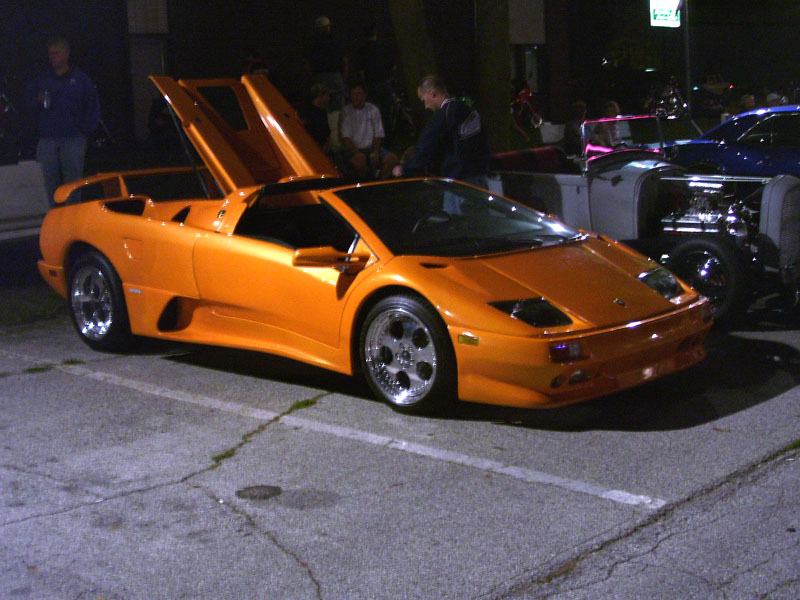

seems like theyre all on stretched chassies, just wondering theres a place down here in Florida that has them in stock, it comes in two pieces front and back pieces
look at the stick in front of the wheel "brake" lol

The third car I know for sure is a stretched Fiero. I know because the car won a few awards in 2007 and I recognize it. The first one looks to be stretched as well, but is based on an earlier Diablo design. The black one looks to be a stretched 6.0 Diablo rebody.
Yes pretty much every Diablo rebody in existence has to be stretched. There used to be a few non-stretch ones, and I've seen one in person, but the wheel base difference is far too great to try and modify a stretch body to fit a non-stretch Fiero.

It does look very odd. I wish I had photos of the one non-stretch I did see. It looked very much like a Diablo from the front and rear, but when you got to the doors the sail window looked like something from a Testarossa. All the windows were tinted pitch black. The doors were also considerably smaller to make up for the eleven inches missing in the wheelbase, as I imagine it would have been very difficult to place the doors further into the body near the rear wheels...
EDIT!!!!! : Apparently, EuroworksLTD at one point reproduced Mirage X's http://www.euroworksexotics...gex_PhotoGallery.htm , which are non-stretch Diablo bodies. You can see by the photo gallery though how different they look from the real thing - just look at the very first picture of the two silver ones.
Do note that the Mirage X is no longer in production, but does show that there should be some non-stretch Diablos floating around out there.

mine is stretched with a v-12 http://switta.com/Images%202/100_1665.JPG
not sure how to post a picture here ?

The actual stretch process isn't too bad, but if you do have to have somebody do it it can cost a pretty penny. You can make the stretch as structurally sound as any normal frame if it's done correctly.

Here's your pic. I took the liberty to adjust the brightness a tad

BMW V12 5.0 right? With the intakes swapped to each other's side? Very nice. I bet that fools a lot of people.

Chassisworks makes a tube frame for the diablo. It can be modified to fit the murcielago. So no, you don't have to stretch the fiero, but if you use a fiero tub with front and back tube frames it will be easier to register. Nice ride Switta!
