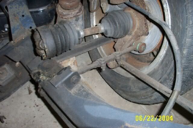

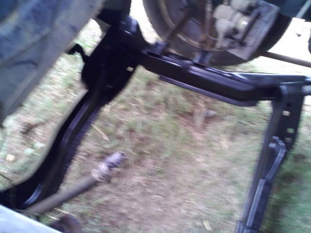

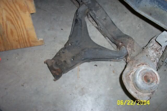

If it has the suspension, there are no A arms.
This is a pre 88 cradle.
This is an 88.
Kinda blurry, but notice the bottom of the wheel? There are two bars that come straight out from the cradle to the knuckle instead of the A shape.
Hope this helps.
As mentioned above, the pre 88's have rubber (stock) bushings on all four attaching points. The 88's are solid metal the metal.

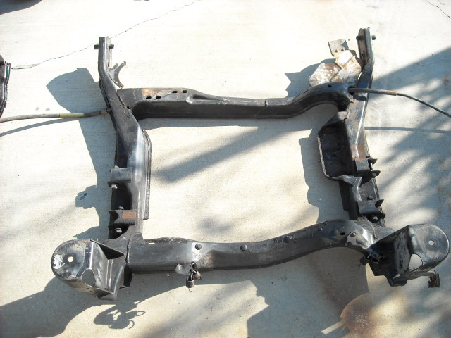

ok thanks guys, i asked if it was from a formula or not, cuz of the sway bar. This is the ad pic, does it look like an 88? Seems to be, from what i can tell..
1988 Fiero engine cradle. It is in EXCELLENT condition from a west coast car. No damage or problems. Nice to have a spare to build up your engine swap or upgrade your 84-87. $125 Firm. Also available with the rear spindles and rear suspension cradle trailing links with new red poly bushings for an extra $100
[This message has been edited by kawana (edited 05-28-2009).]
Posts: 41135
Total ratings: 461
Report this Post05-28-2009 07:03 PM Click Here to See the Profile for RaydarSend a Private Message to RaydarDirect Link to This Post
Sure looks like an 88 cradle to me.
I don't see a sway bar, though.
FWIW. the sway bar came on the Formula and the GT. Both were 6 cylinder.
The only 88 that didn't have a sway bar was the base 4 cylinder coupe.
It also looks like it came from a manual tranny car (at least if it was a 4 cylinder.) The 4 cylinder automatic had an extra mounting bracket welded to the left side, for the goofy uni-mount. Fortunately, the more stable front and rear tranny mounts are a direct bolt-in in all cases.
