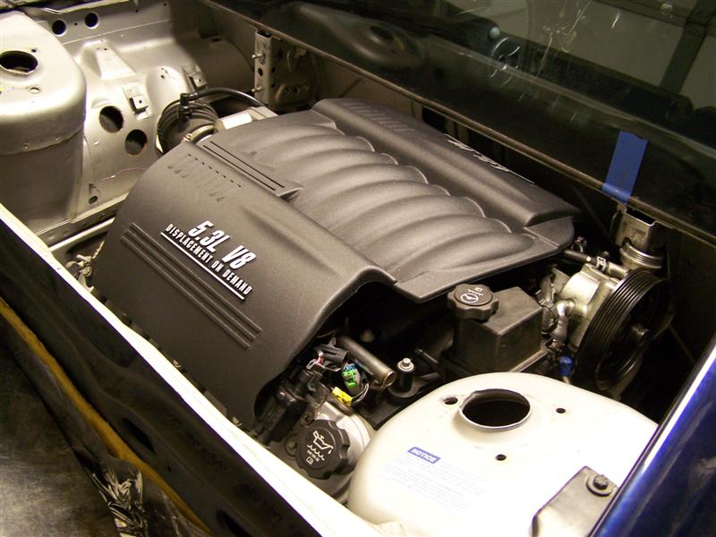

For what it's worth. Been driving my ls4 swap for about 11months now. It has been SUPER dependable, great power, good mileage, and oh yes, sounds FANTASTIC!

I agree that the LS4 is a good engine choice but the active fuel management (VVT) and traction control issues seem to be a stumbling block for a successful completion of this swap. Was it hard getting them under control?
No issues with traction control or torque management (Darth done the programming) I retained the VVT for better mileage along with the tap shift and cruise control.
Correction; It's the DOD/AFM not the VVT (ls4 doesn't have the VVT). Mileage is about 22 average of city & highway. Don't know actual highway mileage.

This is my vote,

Report this Post05-20-2009 08:49 AM Click Here to See the Profile for Tom SlickSend a Private Message to Tom SlickDirect Link to This Post
This is my vote,
not a bad vote if i do say so myself.
1 question, what's that by the passenger decklid hinge? coolant fill? is there enough room there?
thanks...

Report this Post05-20-2009 11:27 AM Click Here to See the Profile for Rickady88GTSend a Private Message to Rickady88GTDirect Link to This Post
thanks...
I cant comment on the details, yet

Report this Post05-20-2009 12:24 PM Click Here to See the Profile for av8fieroSend a Private Message to av8fieroDirect Link to This Post
that is the power steering tank/fill port. unless you're going to add power steering you would remove that pump. removing the pump will get you more clearance in that area but custom poly v-belt routing will be required.

Report this Post05-20-2009 02:11 PM Click Here to See the Profile for Rickady88GTSend a Private Message to Rickady88GTDirect Link to This Post
He is asking about the Coolant fill neck that is inside the Deck lid mount.
BTW I have power steering already
