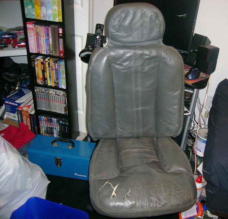

bought a 84 fiero seat with speakers, and turned it into my new computer chair. someone told me i would need an amp, but it works without one on comp, not as loud as comp but decent.

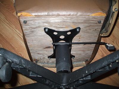

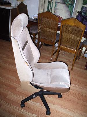

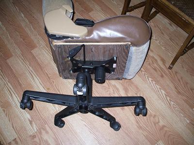

I cut a 3/8 piece of plywood the same size as the bottom of the seat.
Centered the four bolts and then mounted the bottom of a cheap walmart chair in the center of that.
Its very stable and doesn't tip at all. I have it reclined 2 clicks from the full upright position and can go two more back before it feels unbalanced.
