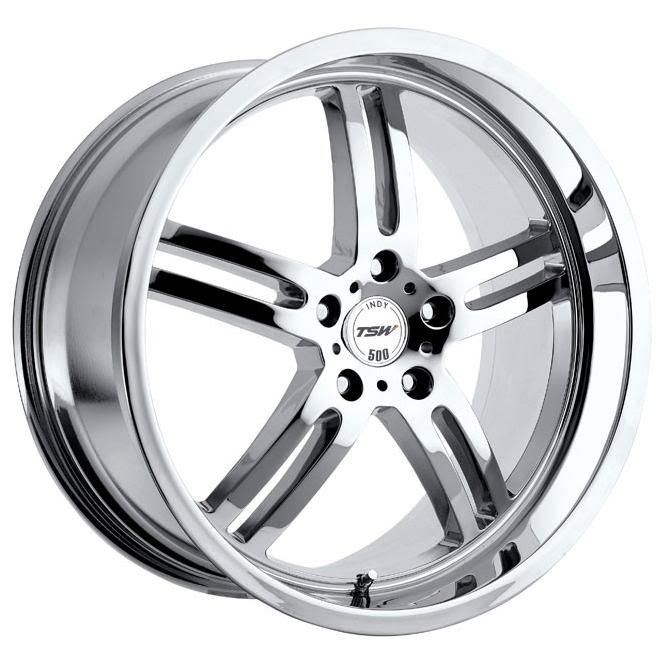

OK now I got some tax money left and I am thinking wheels are next. Already got fixed headlights, t-top kit, and stage 2 side scoops this year, so not much else to do.
I am struggling to figure out what I exactly need to order. All the wheel laces that will tell you what fits your car, do not have anything that I like, so gotta figure it out myself, since I can basically get any wheel on the planet in the 5x100 lug pattern. I am currently running 18x8 motegi mr7's with a 42mm offset. So far the TSW wheels are looking like what I want, or something very similar. I want a wheel with as big as lip as I can get with still staying within the stock wheel wells. Planning to run 18" fronts and 19" rears. Any help would be awesome on how I can figure out exactly what will fit correctly, so I don't have to order wheels and return them because of fitment issues.
Here's a idea on what I am looking at

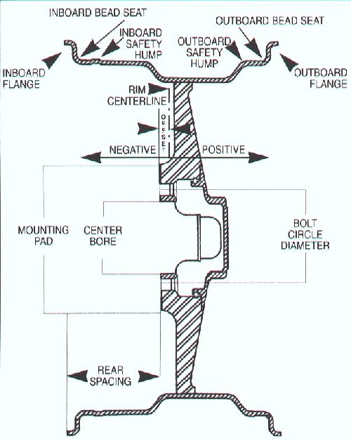

It is interesting that no one on this forum uses the term "backspacing" It is so much easier than trying to figure out the metric system. Whenever I need wheels, I just say a 5" or 4" backspace and the order is complete.
Here is a photo to figure out spacing. You can measure out from your brake caliper face to the fender edge and subtract that distance from the width of your wheel to figure out the proper offset wheel. Here, the person is measuring the wheel offset to figure out how deep the wheel will sit in towards the car.
