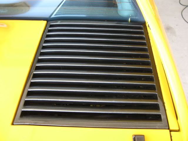

The rear deck lid vents on my fiero are getting, well, old and they need a new coat of paint.
can I use of the shelf spray paint or do I new to use a higher heat, or specialty paint?

I would recommend a semi gloss black engine enamel from Duplicolor. It comes in a spraypaint form and is ceramic and resists heat up to 500 degrees. You can also get a high gloss from them but the semi gloss looks stock.

X2 Just get the engine enamel kind that holds up to heat. The vents don't get as hot as the engine, but the regular spray paint might bubble on you.

I always just use Krylon BBQ black. Just the right amount of gloss and takes engine heat just fine (made for painting BBQ grills). Easy to cover with 1 or 2 coats and no runs.

Paint stripper is fine with them off the car. Just make sure you clean and rinse them thoughly, then wash them some more. After stripping, I usuall go over the whole piece (or metal car body) with a scotchbrite pad soaked in laquer thinner. Then you need no further sanding at all and everything is gone. Krylon is also nice because its self etching...dont need primered, but dont hurt.
