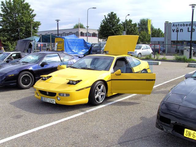

Im going to bed or I would do it, someone post pics of those sweet looking headlights that are custom buckets with piaa or hella lights in em i forget which??
Yellowstones fiero has em and some other yellow fiero last time I seen em and they both looked drop dead sexy with em.

I've seen the fierofan headlights that yellowstone has, they're by far the nicest set up. The hella lights are awesome... but to be honest, a little out of my price range. At over 200$ just for the buckets, plus another 300$ appx for the lights and the harnesses, and in CDN dollars + shipping, + border taxes, I'll be at 750$ by the end of it. I just don't have that budget for headlights.
I wish someone would make headlight buckets like these to fit the stock location. (in fiberglass, not cf to keep costs down):
http://www.advancedautomoti...ks/images/miata3.jpg
With a lexan cover, or even bare, so they could accept two round lights. Then hopefully we could find an inexpensive source for round lights maybe 90mm or 75mm like in the rx7 aftermarket headlights on ebay and we would have a great looking, inexpensive set up.
