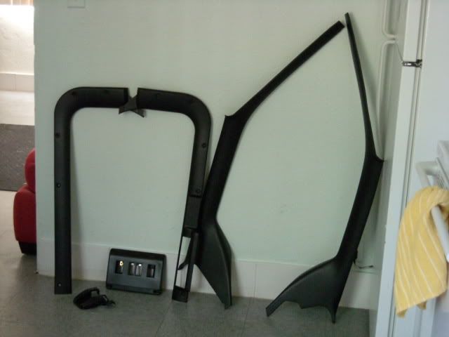

I will be changing over one of my Fieros interior to black. I am not a huge fan of painting the interior cause of my fears of maybe smelling like paint, paint flaking off, cheap shine to the paint ETC... I was wondering if anybody has wrapped the interior pieces (Plastic) with leather or vinyl? Is it even possible? I have fallen in love with black carbon fiber vinyl and that is what I want my interior to be. I was going to get a F355 interior from Amida with the carbon fiber vinyl but I had to get an engine swap done instead. Any info?

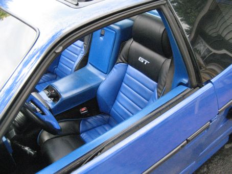

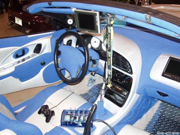

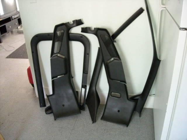

I have done several interiors this way. I have used vinyl with great results. It takes time and alot of will power not to throw the parts across the room. I removed all the interior. cleaned using hot water and dishwashing soap. let dry overnight then roughed up using very corse sand paper. I bought a gallon of interior contact cement and a spraygun. laid out a simple piece first sized up ther material and cut a rough shape with plenty of overlap. sprayed half of the material and half of the piece and gently pressed together. continued with the remaining half. used a heat gun for difficult spots and once the front section was complete trim leaving about an inch and spray the back side and fold over leaving about a .75 inch fold over. trim the rest off.
the blue one is not a fiero but another wrap job I did.

Thanks for the info but your pics are not right...

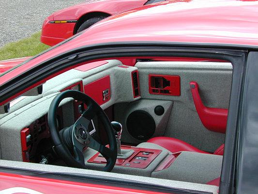

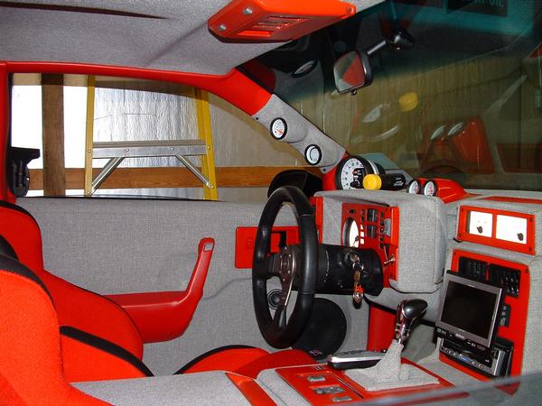

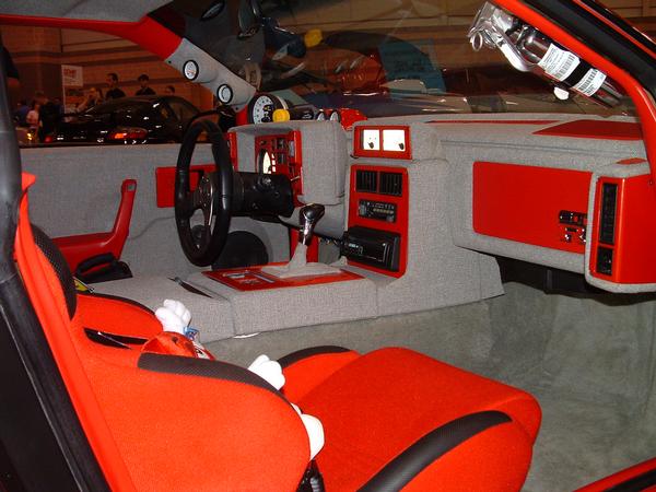

That tweed fabric is easy as hell to use, stretches and curves to the hardest forms. I see a LOT of interiors done with it. Leather and vinyl are a lot harder and usually requires at least a bit of sewing and a heat gun. Its easy to do a headliner in leather or vinyl and it looks great. As long as you really CLEAN parts, plastic paints are fine, use a low gloss clear if you dont want it to shine. Ive had cars with gloss interiors and its annoying at the least to drive at nite.
