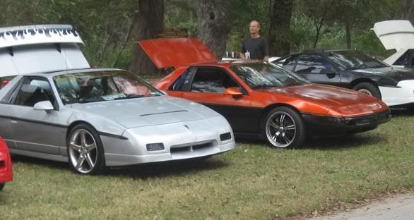

I think whether or not the 18's look too big depends on the wheel itself. I have 17" fronts and 18" rears and the rears don't look big at all, while the fronts look a little small. However, my friend has 18's all around and they look a little too big all around.
I couldn't find a good side picture of his car, but here is his silver car next to mine and you can see how much bigger his front wheels look, despite only being a 1 inch difference.
Ride quality depends most on the sidewall profile you go with, I originally went with a 205/45 in front and a 245/40 in the rear... it felt fine, a little harsher on bumps but it was more than made up for in turns. Next set I decided I wanted to go lower so I switched to a 205/40 and 255/35... it's a little too harsh now. This is with cut springs, KYB shocks/struts, and all new (rubber) suspension.
Overall, for a car you drive often I would say 17's are a better choice (especially on a pre 88 where 18's are likely to hit in the front).

Originally posted by pumpkincarriage:
...(especially on a pre 88 where 18's are likely to hit in the front).
Whoa! I didn't know that! Is that a fact? I have 215-35-18 to be put in the front with a 1.5" lowering spring... I was more concerned with the rear as it real close to the spring (I have the 1" lowering for the back).
How wide of a wheel are you using? My friends silver car (an 86) and mine (an 88) both have 8 inch wide front wheels and our cars are lowered about the same amount when turning the steering wheel his fronts hit much sooner than mine do. I can't give and exact amount, but mine hit at full lock to lock, his hit before the steering that point. I have heard similar things from other Fiero owners as well, so I assume it is a fact rather than a coincidence.
I don't know anything about the rears on a pre 88, the silver car has spacers so there is no issue.
