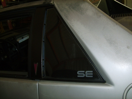

I removed the glass from the 84 frames, then used the double sided stickey tape to mount them onto my 86 frames. The glass part is held on with a plastic trim that I cut off with wire cutters. The one edge is a little bit more difficult to remove. I've had them on my 86 for about 18 months now.
The 84's mount onto the body a little bit different than the 85's up. I didn't have the rear edge metal retainers for the 84 frames. They usually disappear when you remove the 84 frames from the body.
This was a man trying to take my Fiero last Xmas. You can see the glass panels mounted.

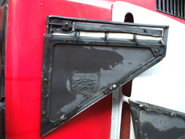

Report this Post10-01-2008 06:27 AM Click Here to See the Profile for Jake_DragonSend a Private Message to Jake_DragonDirect Link to This Post
You can kind of see where the studs are in this picture, mine are cut off and the person that installed the panels just use the one bolt and glue at the studs to hold them on. I had the car for 3 years and they stayed put, it was my daily driver.

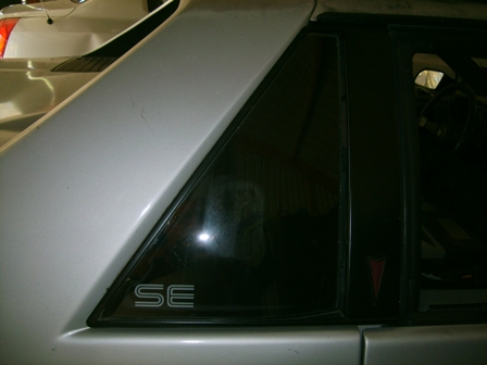

Click for a larger view, please disregard the camera quality, and the ugly dude in the reflection.

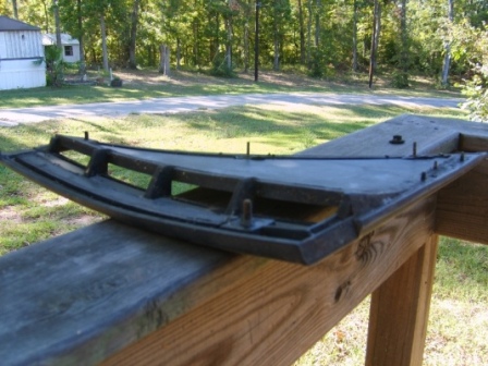

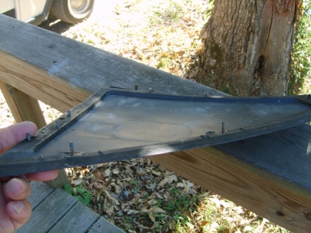

Here are two shots of the 84 frames unaltered fresh off of a parts car: You can see the side with the three small studs. The lower two when mounted are the ones that catch on the metal tabs/springie thingie's. You can also see that the larger stud is made onto the frame. So one must remove the inside trim to access the nut holding it on the car. There are several plastic stud things along the bottom edge. I guess that is what someone was refering to when speaking of needing to drill holes. I would just remove these if they were in the way. Cut or grind. These are really easy to mount on 86 frames, or to mount whole on the 86 car. Nuff said
