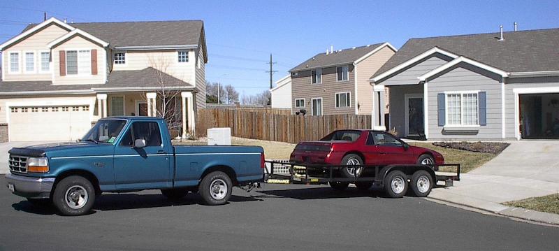

Here's the utility trailer I used to tow my 88 coupe back from Colorado Springs to El Paso. It was 16' long by 78" wide. The Fiero fit on it just fine, but I had to crawl out the window. Since it has manual windows, I could then get the door open far enough to roll up the window. A trailer without the side rails would have been ideal, but this is what I had, so I made it work.

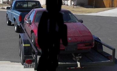

Here's a rear shot. Forgive the darkened shadow....I don't know if the seller would want his pic posted, so I'm blacking out the image.
As you can see, it's pretty tight. Either a wider trailer or a real car hauler without the rails would have been better.....but this is what I owned at the time. The other issue is that with the weight of my trailer and the Fiero, the F150 was near it's towing limit....particularly since I was towing in the mountains of Colorado. I debated taking my F250, but it has a 460 and a voracious appetite for fuel. In retrospect, it would have been much easier with the bigger truck....but in 2005, gas had hit the princely sum of $2.00 a gallon.
Anyhow....less than six and a half feet wide and it's probably not going to fit. Also, I towed this car backwards....which isn't a great idea, as there is a fuel mileage penalty. The car is much more aerodynamic going forward.
[edit] You'll also notice on the rear shot that I put the car's passenger side as close as possible to the edge of the trailer for a little extra door clearance on the driver's side. It did help. And the car being offset slightly did not upset the balance of the trailer...I towed it home at 70 mph with no sway or other issues.
Hope this helps.
