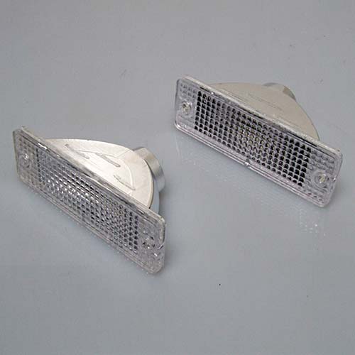

You need some of these and/or the clear cover for them.

Originally posted by cornersonrails:
The front fascia I wasn't planning on doing anything with but the turn signals :thinking: Now their is a thought. Any sugestions on what lamps I could fit in their? I also was thinking of getting that hood extractor from the post above but decided not to.
As far as turn signals/ parklights... I'd look for a set of JDM FD RX7 lamps. Always thought they would look great on a Fiero. They are a bit bigger than the Fiero lamps, but should look good with the 300zx lamps.
A quick pic from ebay
[This message has been edited by topher_time (edited 02-24-2009).]

Hello my fellow Fiero Junkies
Well I started this thread with the title, "Giving the Fiero Lasiks 300zx style"....I knew not what I was getting into but wanted to document to all what I was doing, the problems that I was facing, and what I had done to resolve the issues. This thread was intended for those who wanted to add these lights in there cars to be able to see what kind of work was involved in doing so. I had never claimed to be a professional and had stated that others can do what I am doing probably a lot better. The GodFather has shown that their is more than one way to do it. I feel that I have achieved this goal and have seen it through from beginning to end and I am satisfied with the end result. I want to thank everyone who has given me inspiration and words of incouragment along the way. I titled the thread, Giving the Fiero Lasiks 300zx style and it has been done. This thread has run out of string....lol. Thanks to everyone, Chris

Hey Chris, how about a pic at night with the lights on? Now that its done I'm just wondering how good it looks.
Thanks
Joe
