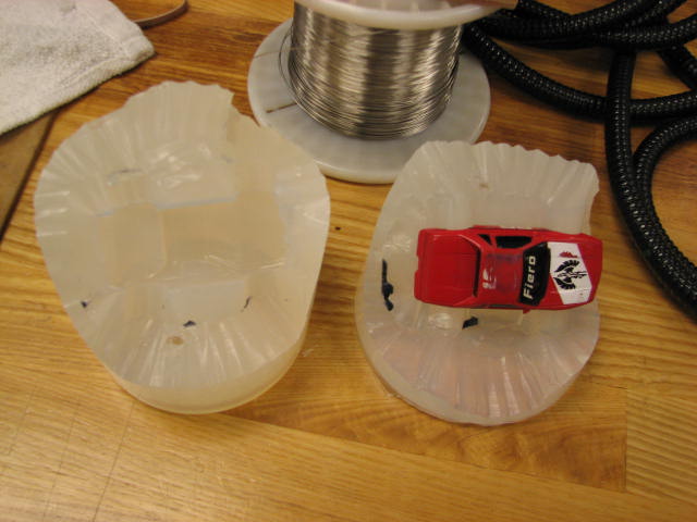

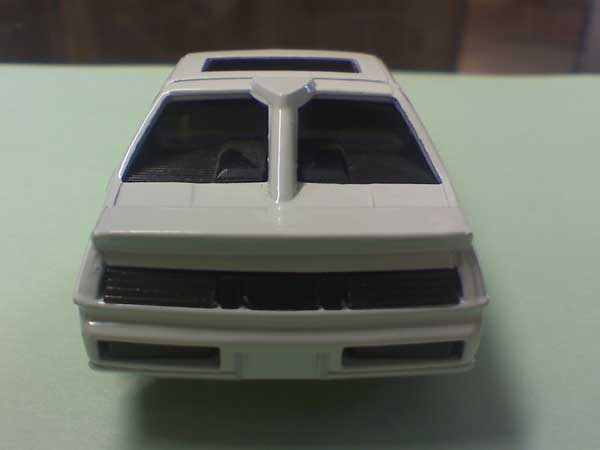

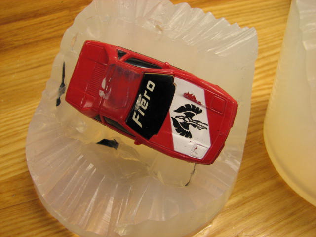

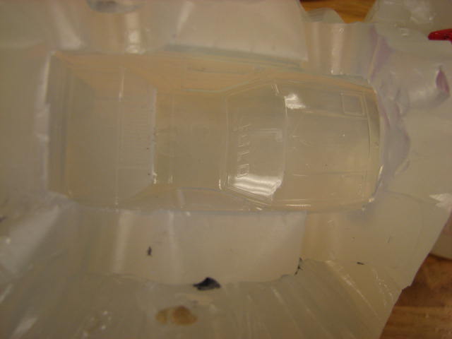

So I bought this slot car, and made a mold from the body.

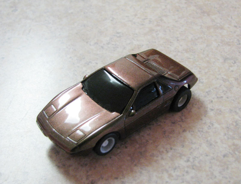

So from that silicone mold I shot in some urethane and grabbed some of the flip paint from my car and made this awesome slot car replica of my car. I need to add a spoiler but it is really close...now I need a track.
Here is my car for comparison.
If you want one let me know, I need to find out shipping costs, it would be raw urethane for you to paint how you like.

I feel bad that original body was in mint condition. I had to pack the under cut formed from the front facia curling under with clay. When I pulled it out I decided to disolve the clay out with Bestine which never ever attacks paint or graphics but eats out Klean Clay for casting. Well guess what? Bestine if left on a Tyco slot car finish for an hour will make it blister a little. So I tried to buffit out on a polishing wheel. I was working until the buff grabbed the body. WHAM! right into the wall. I hate it when I do that. I was surprised to see it in one piece. However it had a nice big scuff across the roof and hood. So in this case it didn't buff right out. Anyway I would say $3 for urethane and $3 for postage could get you a raw urethane body. Pm me if you want one, when I cast more I will let you know.
I'm searching eBay for a replacement for my scuffed body. These slot cars are cheap.
