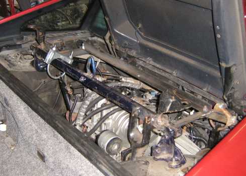

I have a jig I made up that allows me to drop the cradle and tilt the engine/tranny down on the one end to allow the tranny to slide right out the side. I don't even have to remove any cooling lines to do the job.
Last time I used it I had the clutch changed and the car back together in about 3 hours.
It took me about ten hours to make the jig for the first time I used it but it was time well spent in my opinion. Dan
You should offer the service whereas most places want a lot $$ to d a Fiero clutch.

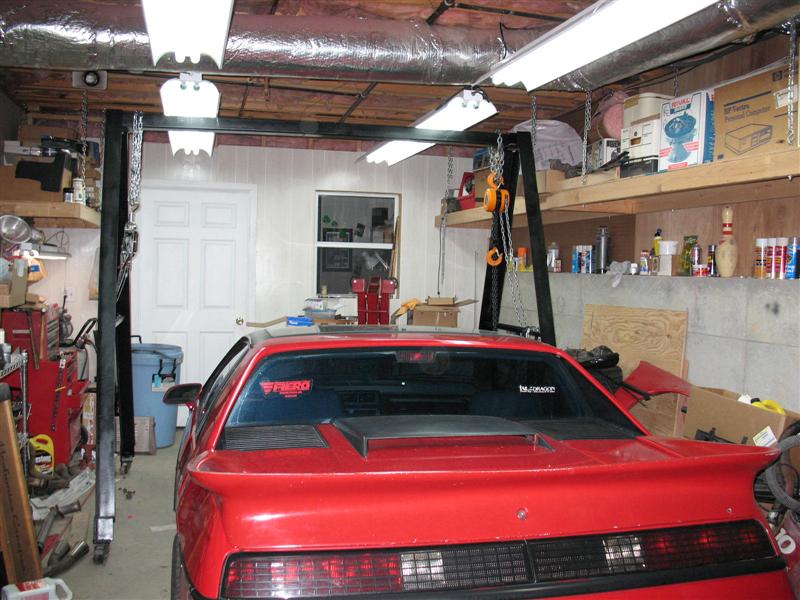

I've never done mine on a "rush" basis, but I'd imagine that I could do it in a day if I had to.
I've got a big steel A-frame in my garage. (I call it the "swingset from hell".) I roll it into position over the rear of the car.
I jack up the back of the car and support it with jackstands under the rear of the passenger compartment
I use a chain hoist with one of those engine leveling attachments to support the engine and tranny.
I take the struts/knuckles/hubs out as an assembly, yank the axles, and then unbolt the exhaust system and mounts, and drop the bare cradle out.
Then I unbolt the tranny, tilt and lower the engine with the leveling attachment and chain hoist, and use a come-a-long to lower the tranny down out of the engine bay. Chains are strategically fastened to place the tranny at the right angle to detach from, and reattach to, the engine.
Assembly, as they say, is the reverse of disassembly.

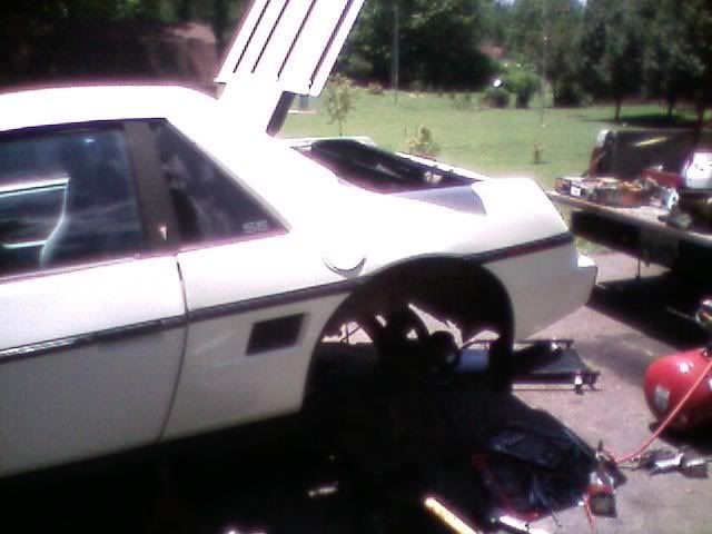

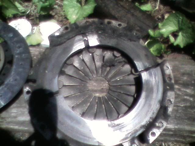

I'm doing a 4 banger right now because the pressure plate broke. All I did was drop the drivers side of the cradle and the tranny came right out.
I would assume that at the least the engine needed support and that the entire strut assembly needed to be removed

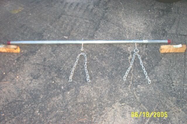

My record for removal is 1 hr 47 minutes from running car to tranny on the floor (and no impact wrenches). For clutches, unless there is a good reason for pulling the engine, I use a engine sling to hold the engine in place, drop the cradle and pull the tranny from the side. I do not rush putting it back together, but 2 1/2 hrs for reinstall is about normal for me.
I mastered this method when I needed to pull the tranny and I was 1000 miles from home - pulled it in a rental house (rented for the week) with a floor jack, jack stands, and tools from my travel tool box. I stopped by home depot (or some other hardware chain) and made this engine sling.

When I first made it I used and exhaust clamp to lower the tranny end but ended up welding on a few nuts to be able to use a 1/2" threaded rod instead.
The main point stated above is that rusted or siezed bolts can seriously slow things down. Dan
