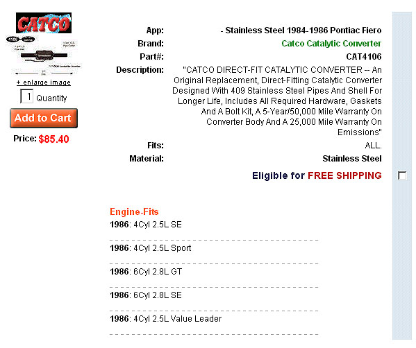

How much different is what Rodney Dickman sells compared to the following from Race Pages? There's a $40 difference in price (when the shipping is factored in). Both are adverstised as bolt-on applications made of stainless steel by Catco.
[This message has been edited by Patrick (edited 03-29-2008).]
