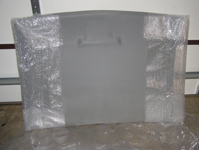

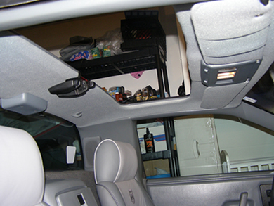

It's a great product! I have it installed along with the new visors. Breathes new life into the interior. It's also a big timesaver since it's pretty much ready to go. You also don't have to stress about the backingboard snapping in two (or 3) while you're installing it. I also installed a new sunroof interior molding since mine had shrunk some due to age. Here are some pictures.

Are you talking about the gray rubber strip that holds the cloth pinched into the stainless groove that runs around the sun roof opening? If so, where did you find one that wasn't black?

Thanks for the feedback and photos everyone.
It looks like the notches for the sunroof, dome light and brake light need to be cut out. Can you leave the cut out in place for the brake light if you want and will it show? We have a different LED Brake light we want to use so we don't need the large cutout in that location.

Yes, that's the one. I just ordered it and that's the one the Fiero Store sent me. It was the same color as the original.

You can leave it in place, but it may be slightly noticeable if you're looking at that area. Maybe you can just add some kind of backing in that area to reinforce it and make it less noticeable. Cut out a section of plastic milk jug and bond it or something like that.
