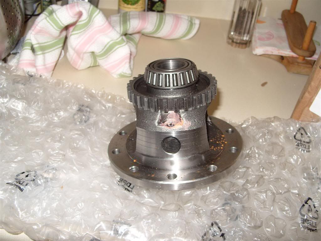

I just got this from Jeff Ianitello at Engineered Performance. With the custom LSD setup (check the last pic, you can see the fricion clutches on the side gear, they are brass), it came to $700. It included a NOS late-model getrag diff (stronger, and 0 miles).
It supposedly has about 50 ft-lbs of bias torque once it wears in, but I have no way to test it ATM. I know I cannot turn the gears with my fingertips, lol. It has been discussed many times on the forum, but as fas as I could find in the archives, no one here actually has one.
I realize it looks a lot like the much cheaper "Phantom Grip" (This LSD costs $500, the Phantom Grip is $330 with "upgraded" springs), but it actually uses real clutch material to generate friction, it does not rely on the gears grinding on the diff case. Here is a thread about the problems with the Phantom Grip:

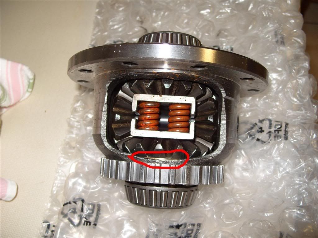

The picture below highlights the friction material I am talking about.

Nice set-up and it's good to see somebody getting what they want and not trying to go the cheap route. Keep us tuned as to it's quality. Byw, I too have them on two of my N* autos.
"Anyone can make a copy of something, it may look good, but never is the real car. Make something from your imagination, something unique, something nobody has, anything is possible and, ideas can become a reality; Archie and the Crew can make your Dreams into a reality."

Madcurl, I thought you had Phantom Grips or GR8Grips? How do you like your units, did they affect the handling at all? How well do they work and how many miles do you have on each one?
madcurl
Posts: 21401
Total ratings: 314
Report this Post02-29-2008 05:21 PM Click Here to See the Profile for madcurlSend a Private Message to madcurlDirect Link to This Post
I'm not sure of the name or if they're the same as yours? D1S installed them many years ago, but I'll ask him this week the about the name. The price was around $700 bucks or so (I do remember the bill, hehe) I've been up and down, left and right across America and so far-no issues. I have them installed on #011 and #020. I've noticed the difference on #015 since it currently doesn't have them.

Nice to see another choice out there So when are you going to test it out?
Stay tuned!
How significant is 50 ft-lbs of bias in a situation where the output torque to the axles is on the order of 2500-3000 ft-lbs?
Bigfieroman
Posts: 2416
From: Pleasant Hills, PA, near Pittsburgh
Total ratings: 116
Report this Post02-29-2008 11:04 PM Click Here to See the Profile for BigfieromanClick Here to visit Bigfieroman's HomePageSend a Private Message to BigfieromanDirect Link to This Post
Here is a post made by Will in regards to bias torque:
"PG [Phantom Grip] has about 25 ftlbs of bias torque.
GG [GR8Grip] has about 40 ftlbs of bias torque.
Bias torque is the amount of torque is takes to turn one wheel relative to the other. An open diff has zero bias torque.
When the car's in a hard corner the inside rear tire loses grip. When you apply throttle, you can overcome the grip of the inside tire more easily than the outside tire, so the inside tire spins first. When you have a limited slip of the varieties we are discussing, the bias torque helps prevent the inside rear from spinning by holding it with respect to the outside rear tire. 40 ftlbs may not sound like much when the torque delivered to the diff is something like 2500 ftlbs in 2nd gear, but a little goes a long way. 40 ftlbs is a little bit below the threshold that induces understeer, so it should not have a negative impact on handling, other than curbing corner exit wheel spin. There's a diff for Datsuns that is spec'd for 80 ftlbs of bias torque and it requires changes to suspension tuning because it induces some understeer.
In a straight line, the friction works to curb the tendency for the first tire that breaks loose to keep spinning. It will cause you to spin both instead of just one, unless you're on a split friction surface... one wheel on gravel or ice or oil or something."
Now, I was a little unclear as to exactly what Jeff said when I asked him about bias torque. I know he said that his normal unit has 50 lb-ft of bias torque once it wears in. He then talked about some prototype he made that induced ~90 ft lbs but it was too much for FWD. I THINK he mentioned at the end that my unit for RWD would have stiffer springs and greater bias torque, like 90 ft lbs, but I don't know for sure. I have an e-mail in to him asking about this now.
I know the unit does work, even with the wheels turned. The pic below is from his site. The 3800 SC Grand Prix floored the gas with the wheel turned significantly. There are 2 stripes curving in the turn. Now...that COULD have been faked with a RWD car with an LSD sliding the rear a bit as it did a burnout, but it looks real enough for me. We will see how well this thing works after it is installed.

I think those torque bias numbers might be a bit conservative.
80 lbs might be significant to an old 2040 lb Datsun 510 with 40% of the weight on the rear and the equivalent of 155 section-width tires, but on your 275 section-width gumballs on a 2800lb car with 63% of its weight on the rear, you could probably run more.
These guys suggest LSD maintenance when bias is under 100 ft-lb, and give a ballpark recommendation (which though its intended for F bodies and Chevelles, they are also RWD with about the same weight in lbs on the rear wheels) of 110-140 ft-lbs bias for streetable SCCA performance.

30 seconds of severe wheel speed differential could have caused that. That would have given it enough time to heat WAY up and just grind the crap out of it. I am not sure that is the reason, but it could be. No thanks on the diff, I spent enough on mine already.

Jeff just answered me. He said he has seen 50-90 ft lbs of bias torque on his units. I will measure it once I have it in.
