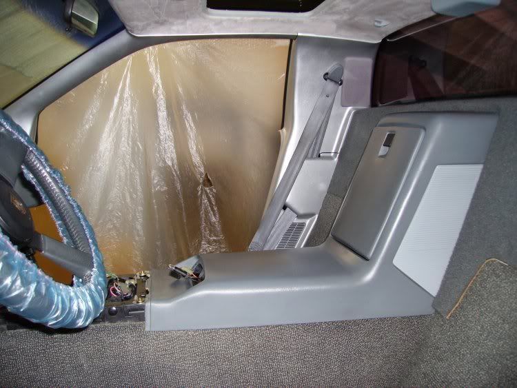

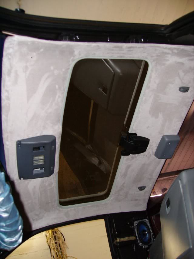

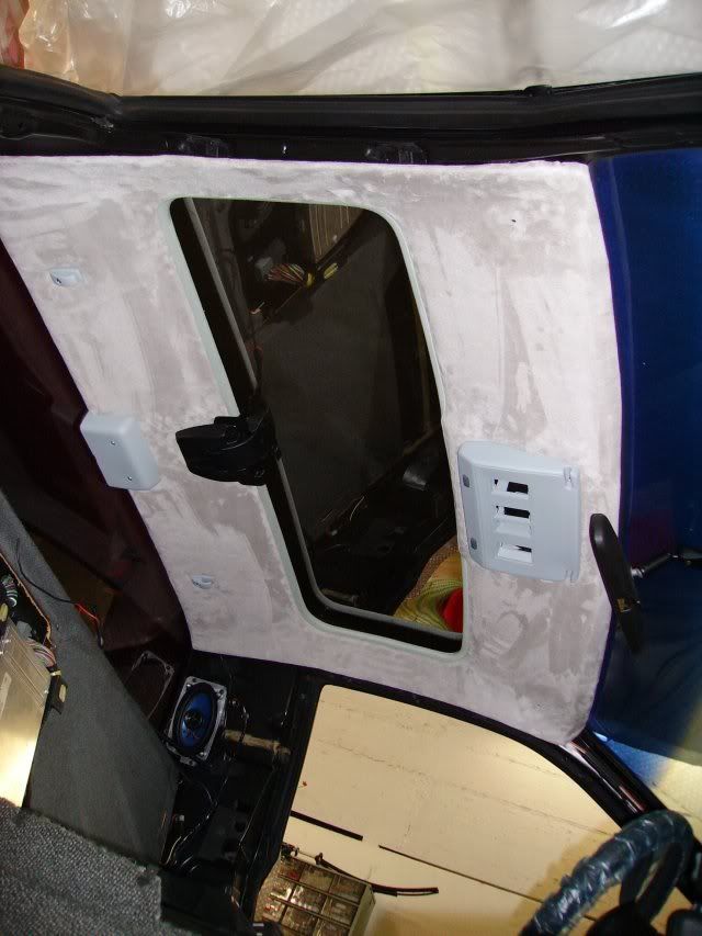

Its easy to make to DIY it , but sure u need some skills and some tools .
I did it this way : reinforce your headliner with epoxy or resin paint it to seal it and apply with a spray gun the glue to both parts let it dry as gluebox says it and pull it over where you want it , big parts need help from a buddy .
Sunvisors was a peace of cake , this you can do easy yourself and its good to make a test run for the big stuff !!!!! .
My suede leather is feak ,this stuff look like 1000000$ exotics but the coasts are bye Zero .
So hope this will help and I/ We like to see pics in future !!!!!!.
Greets,
Kai

Originally posted by Alex4mula:
Could you please elaborate how you did the sunvisors? Tks
Easy ,remove the screw from visor and pull the mounting part of , the rip the part of from the visor the gray sh** but do not destroy the carboard under it !.
Rip the gray tex stuff from carboard and copy the carboard to a new peace simular to the carboard , I got mine from the pencil and school stuff shop they have thick paper
stuff -carboard use the old one for sample in shop .
Then copy old to new ,fold it like the old one and make same method to glue .
Put the cloth over it let it dry . Then glue both sides like the old one together , look for exact lines .
I used hot glue !!!!!!!!!!!!
Hope this help !!!!!!!!
