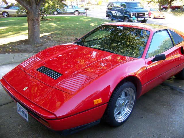

I made the grill on the front of my 328 by cutting two rear grills in half and joining them with JB weld and 1 inch of extra grill material underneath. It is very strong and the seam is invisible.
