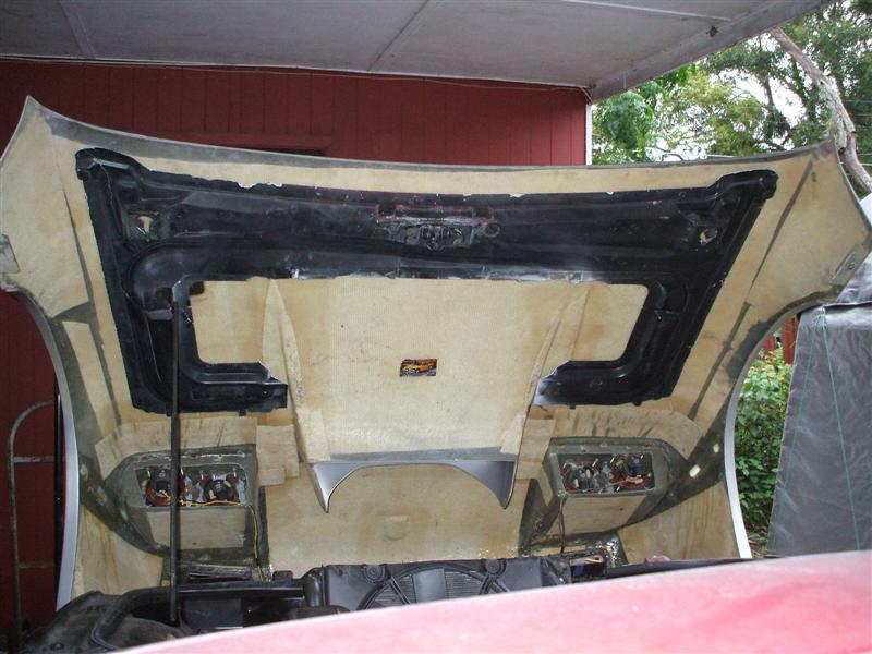

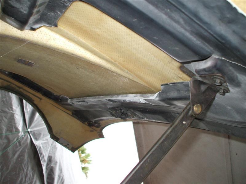

These are nice looking cars but I have concerns about the nose on the gray one. At Carlisle this year there was a girl parked next to me that had this front end design. It was hinged at the front and latched at the windshield side. While I admired the nice look she was quick to tell me that at 70 -75 MPH air gets under it and the nose starts to shake violently. As a result the car must be driven only below that maximum speed. I would guess that at 100 MPH that nose would be in danger of breaking off and flying away. Point is that modified looks can be great but only if the body parts are mounted as is soundly as the OEM design.
I cut up the underside of my stock hood and glued it to the bottom of Norms hood.
Big difference.
