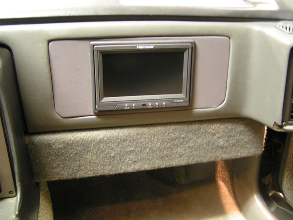

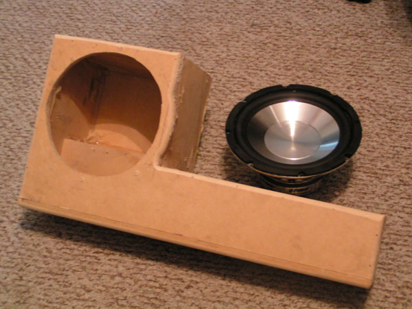

I'm running a JBL 75w mono amp that I bough off of our local online classified site for $50,and a Q Logic 8" sub that I got from a buddy that runs a computer store that set me back $10.
The sub is mounted in a box under the passenger side of the dash.The amp is mounted behind my drivers seat.
I think it sounds pretty good...for what it is.

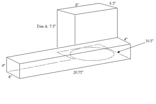

Hey that looks great do you have the specs on the box?

Sure...I got them from another thread on this forum.
I wish I knew who they originated from so I could give them proper credit.

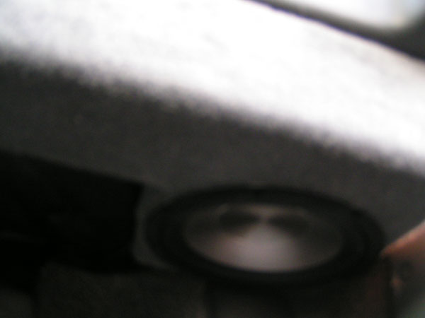

I've got a 400w Clarion running 200w to a 8" RF Punch and the other 200w to the two dash speakers. The sub is mounted under the passenger dash as you can see here and the amp mounted to the wall behind the passenger seat.
