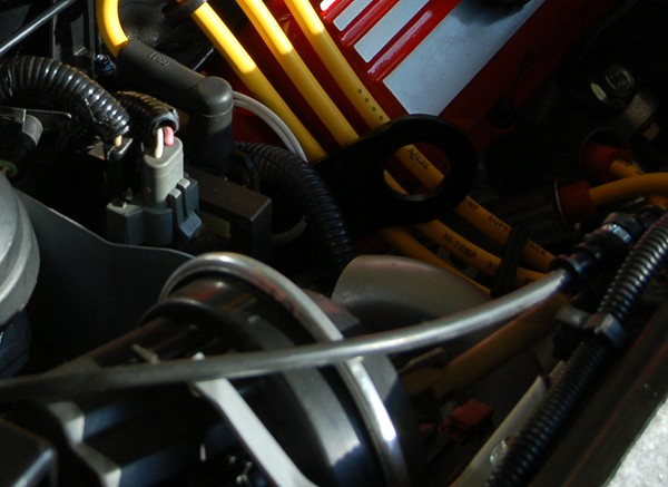

Some current engine pics, the CRX intake is only test fitted in there, nothing is tight and the bottom peice and the filter isn't even there right now. I have cleaned the wires with thinner, painted a few things, done alot of cleaning etc, my next move is to pull the car up into the driveway, degrease and hose off the tranny, paint that rusty linkage holder, vacuum off the insulation, clean some more, paint some more, and fix my exhuast leak. I am not sure about that lime green PCV hose, I was taking crap that I was venting it into an area that will easily cause a fire so I decided to run hose to put the breather under the vent. The tubing is UV reactive and I got it for free. I am eventually going to change as much tubing to that as I can and add some UV LEDs in the engine bay, or just pay $.30 at Home Depot to get clear tubing. What do you think?
I am hesitant to post these as my competition may see them....

You're doing real well there!
Use a length of new black rubber tubing. The odd, (green) colored tube looks out of place.
Straighten up those plug wires. Spend $4 for some plastic wire looms to keep them organized.
CLEAN those shock towers and mounting rings!
CLEAN the fuel vapor canister and hoses!
Remove the EGR and paint the whole thing. Its only (2) 13mm nuts and should only take a few minutes to do.
We'll whip you into shape yet soldier!
[This message has been edited by randye (edited 08-28-2007).]

I payed $4.99 for some sh!tty Spectre Wire looms at pep boys, the better stronger ones were $2 more but I cheaped out. Of the 6 peices which look like model car parts, 3 of them broke. I am going to try to return them tomorrow. My car already had two looms on it but they were arranged wierd, so I may get my $5 back and buy something else.
