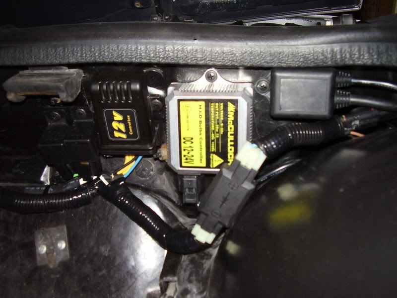

Wiring (Relays, Ballast, Ignitor, Controller):

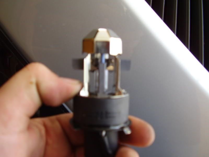

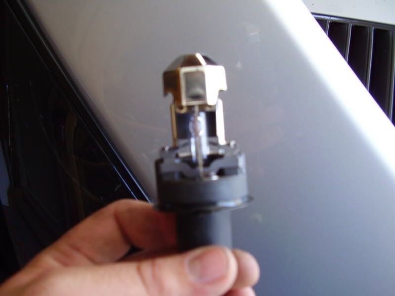

The bulb actually has a moving shutter on it, this is what controls high/lo beam..
Low Beam:
High BEam:
THis is the bulb itself without the shutter on it. It is a D2W bulb:

Now, to go to the H4 HID conversion, the kit was a 'plug and play' kit. There was a connector that plugged into the fiero headlight connector. That connector went to the relays and controller, then the pre-wired kit went to the ballasts and ignitors, then finally to the bulbs and shutters.
The only non plug and play part of the kit was that it needed +12v and ground connected. But that is fairly simple to do. I ended up fully integrating it into the fiero wiring, shortening wires in the kit to proper length and hard wiring it to the fiero headlight wiring instead of using the connector, but that is not necessairy.
