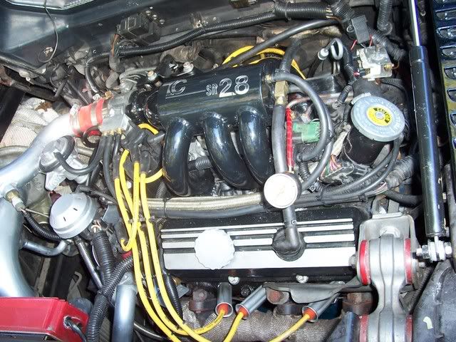

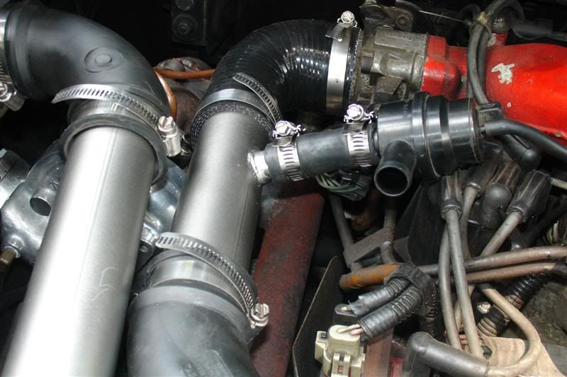

Some old pics...cause i plan on redoing the plumbing, but this will give you an idea.
Garrett T3 super 60. .48 hot side, .63 cold side. Running 11 psi of boost with a ford probe intercooler (that i plan on switching for a dsm intercooler). Stock injectors, but cleaned and flow tested. MSD ingition, blow off valve, and other goodies here and there. Any questions, feel free to ask
just realized these are really old pics because i've replaced all the rubber hoses with silcon ones...so those have all been changed as well.
-Coop

Nice Pics!
Interestingly enough I've been thinking of putting the intercooler in the trunk as well, but if I were ro go air to air I would worry about how cold air was to get into the trunk to feed the IC. Do you have some sort of venting? I would imagine that even though it's cooler it's still pretty hot compared to what it could be out in the open.
Lets see some more!

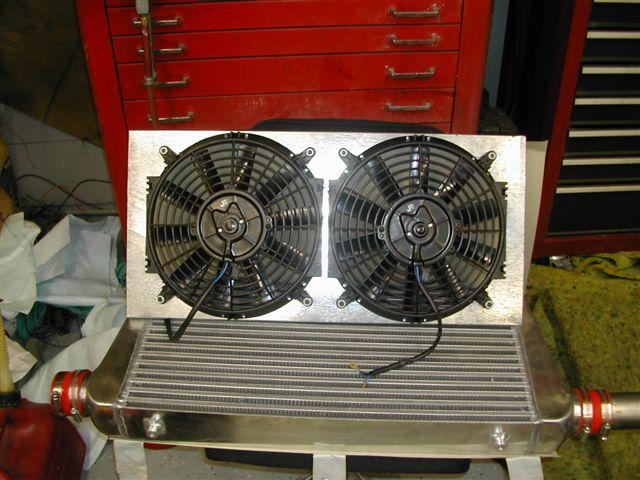

Not mine but...

Nice V8 Setup, I'd like to see some more angles if available. Again, is the intercooler fed cool air by vent?

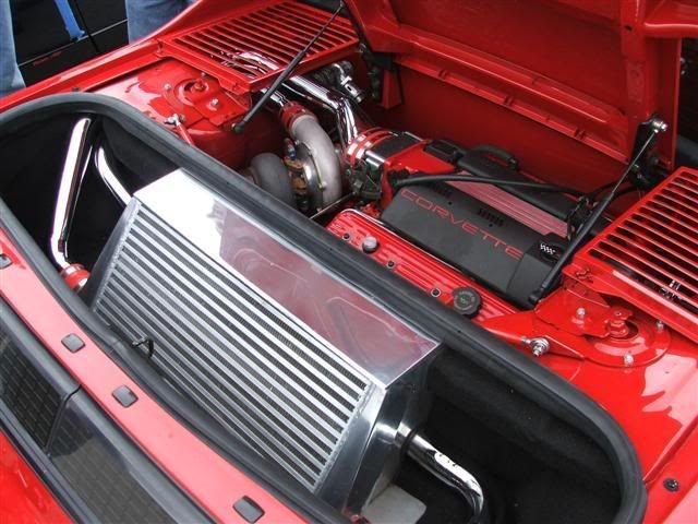

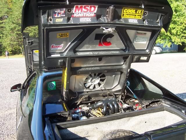

2.8 intercooled, trueleo Intake Headers Chip, MSD, Crane, 9:1 pistons and other engnine mods.
That's a shortend MR2 intercool with MR2 fan under it. And that extractor scoop really keeps it cool in there, thou I sometimes feel like I'm being followed.

Here's close up; MR2 intercooler, fan, and blow-off

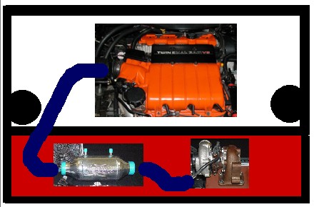

My Idea is as follows....
1) Have Headers meeting at the stock Muffler Location, but instead now travelling into the now cut out trunk area, where the turbo is mounted.
2) Mounting a Water to Air Intercooler Next to the Turbo, on the Left side of the Trunk bay.
3) plumbing back into the engine bay, to the intake.

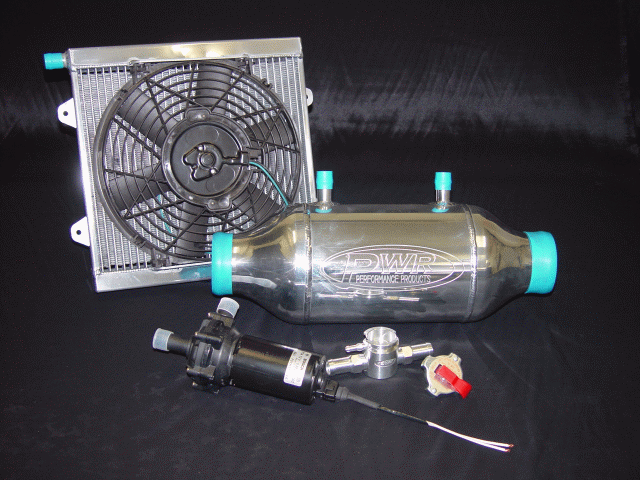

This is what type of Water to air Intercooler I May want to use.

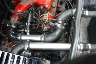

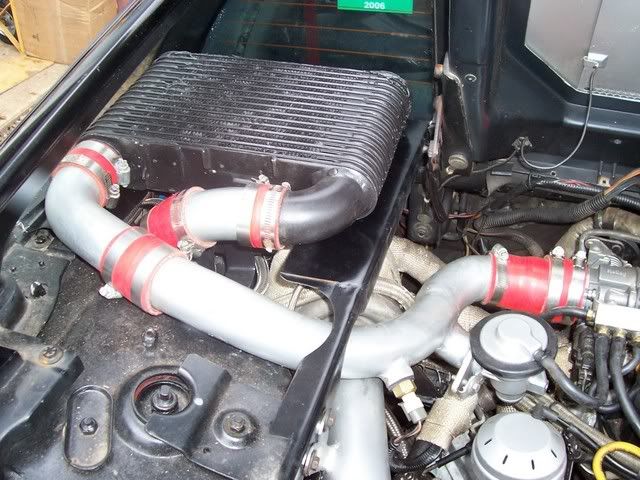

Like this? (old pic)

From what I understand, the response from the turbo not only depends on the size of the turbo but also how close it is to the exhaust and intake. Just something to think about.
tampalinc
Posts: 776
From: Waukesha, WI
Report this Post03-05-2007 07:25 PM Click Here to See the Profile for tampalincSend a Private Message to tampalincDirect Link to This Post
I have my headers, Y-pipe, and turbo high temp ceramic coated. I also have the headers and Y-pipe wrapped and I always run a good turbo blanket. You want to keep the heat in the exhaust.
There are a lot of factors that go into the response of the turbo. Hopefully the Dyno graphs will get posted after Daytona so people can compare the power levels and power curves of the different setups.

Have any more angles?

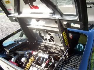

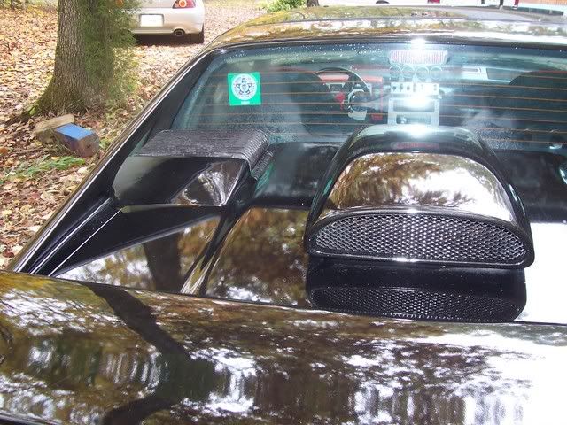

Mine... lol

How do you move the cool air out of the trunk though? Did you vent in some way?
Do you have more pictures of the whole car?
