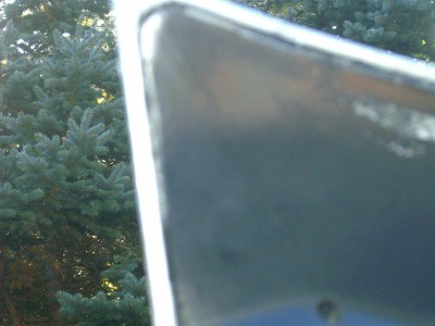

Three tries and it's still too dark! I have a wing and a set of stage 2 side scoops I'd like to mount before the cold weather sets in but I don't know what to do! Anyone else have 16/9004 bright silver mettalic and have problems getting a color match? I'm taking into consideration the paint is going on 20 years old but it's WAY off. Previous owner says the paint is original but this overspray has me wondering?
Maybe it's the mixer and I'll try a different NAPA tomorrow? Here's a pic of my car...does it look the same as you other silver Fieros?

Silver is one of the WORST colors to match - specifically due to sun fade. Also, the overspray shown doesn't look any worse than the other factory paint I've seen - and (from my monitor's rendition of the photo) it looks about the same as my Dad's '88 GT.
My suggestion would be to find a shop that can color match a sample... then bring them in a quarter panel. But beware that the fade level may even be different between a quarter panel and the wing!
