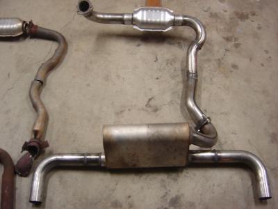

Report this Post08-03-2006 02:24 AM Click Here to See the Profile for fieroman22Send a Private Message to fieroman22Direct Link to This Post
my new exhaust
still waiting powder coating.

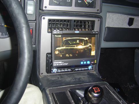

Report this Post10-27-2006 04:30 AM Click Here to See the Profile for fieroman22Send a Private Message to fieroman22Direct Link to This Post
went all out and got me one of these, can anyone tell me what im watching?

Report this Post10-27-2006 08:49 AM Click Here to See the Profile for fierobrianSend a Private Message to fierobrianDirect Link to This Post
gone in 60 seconds ! what do i win just kidding

Report this Post10-28-2006 03:18 AM Click Here to See the Profile for fieroman22Send a Private Message to fieroman22Direct Link to This Post
ha i thought the pic with the stang would give it away.
