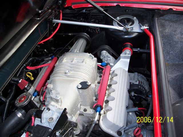

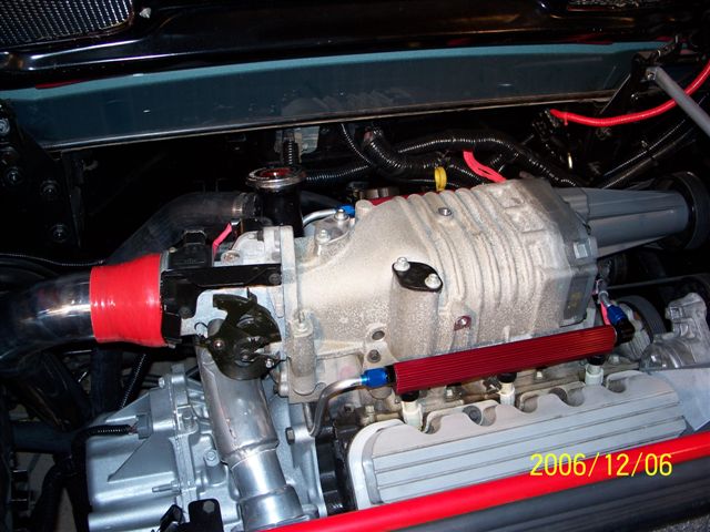

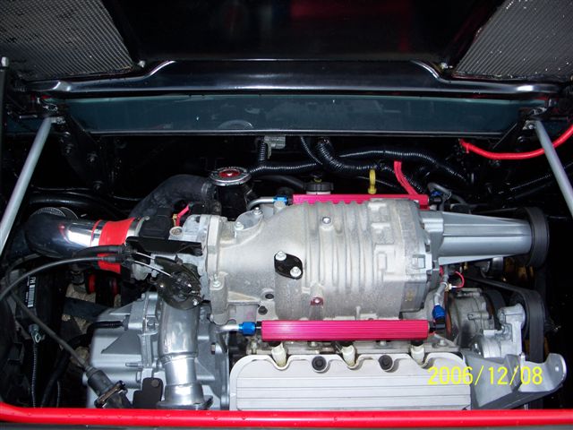

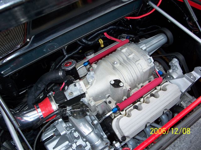

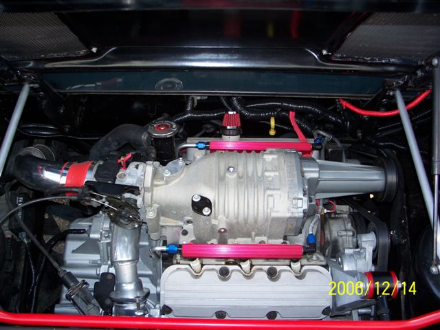

Finally have my mind back on my work these days. What better way than to complete an engine swap project.

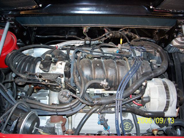

Greg's car came to me with a 3800NA installed. It was done by a company no longer in business, and the install was less than Greg's expectations. So, out with the 3800NA 5 speed powertrain, and in with a 3800SC mated to a 4T65eHD transmission. Project goal was the usual, keep it clean and simple...
It is a 308 rebody on a 1985 GT Fiero chassis. The 3800SC is from a 2001 Bonniville. The wiring is equal to my custom work done in 2003 for another project I had done for myself. I dont usually go to this wiring extreme.
Enjoy the pics... the project page is here with more details and pics > http://www.fastfieros.com/projects/greg308/greg308.htm

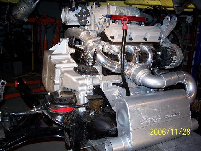

The OLD engine install !!!!!!!!!!!!!!!!!!!!!!!!!!!!!!!!!!!!!

God dang that's clean, I don't know how you do it with hidding the wiring of these swaps, But you do it very very well loyde.
FastFieros
Posts: 2698
From: Dallas Texas USA
Total ratings: 265
Report this Post12-11-2006 06:27 PM Click Here to See the Profile for FastFierosClick Here to visit FastFieros's HomePageSend a Private Message to FastFierosDirect Link to This Post
Just lots of thought and building racecars in the past.... Thanks for the kind words...

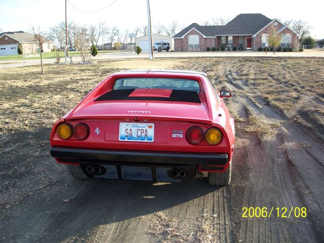

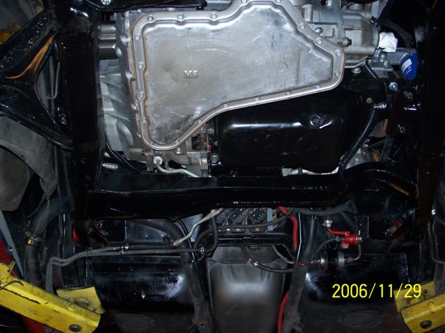

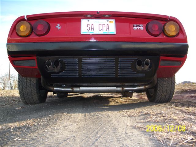

How about the rear exhaust on this car. It just flows so well with the lines of the car...
Underside is getting a cleaner look these days also...

Really clean look..... You did a great job hiding the wires. 1000% improvement on the old swap.

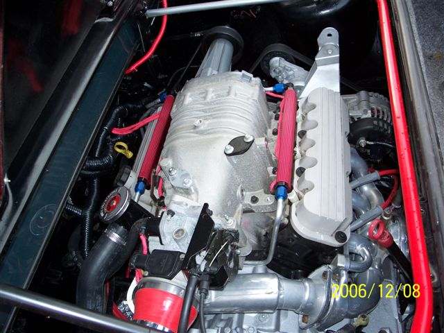

Whats with the 2/2.5 inch intake tubing? The stock gtp setups had 3 inch intakes the were extremely restrictive, most of the race minded 3800's I see have 4 inch intakes.

Yep looks like it is starving for fresh air. Hey Loyde, I have a 4" rubber 90* hose if you want it. ( build the rest yourself)
And what is the "layout" on that exhaust? Same as the usual set-up? flowmaster?
Ryan.... that is 3.110 inches of a mandrel bend tube hanging out of that 3800SC throttle body....making it a 3 inch ID tube on that car.
The customer has the car registered as a "kitcar"... No emission testing in his state. Per customer requests, I build them the way they want them.
Kevin, that is a 3.8 stock pulley on that SC, I am pretty sure that it is getting all the air it needs.
Exhaust is ceramic coated.... paint on the muffler and downpipe area..
Loyde
Hmm, that coupler is quite deciving, but I see how it is 3inch now.
Ok so why is the exhaust 2.5 inches still? I guess if it is stock its ok to have the 2.5 but I am still convinced that the tight curves involved in trunk on 3800 exhausts is alot more restrictive than the stock downpipes, think Ubend, but closer to the outlet.
Not harassing, just wondering why, I really do like the looks of everything, you really do inspire me to do all of my work. BTW my name is Scott, Ryan is darth fiero.
I am going to say being the motor is stock with the 3.8 pulley still on that the 2.5 exhaust will do the job with no problems. Nothing tight about the curves in the trunk area when using mandel bends, its a very short exhaust and flows very well. I dont see it being anywhere near as restrictive as a stock downpipe or U-bend on the GTP.

2.5" exhaust is good to 600hp no problems.
