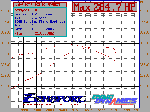

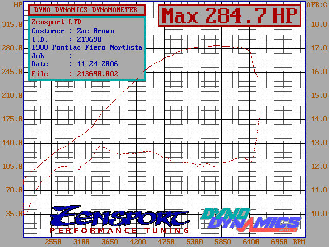

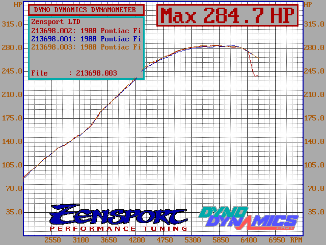

Well, today i got around to putting my car on the dyno. 88GT 5spd, 96 Vin 9 Northstar, headers, spintech muffler, spec aluminum flywheel and stage 3+ clutch, cold air intake and I'm running Ryan Hess's computer. 1st pull was 284.7 2nd was 284.7 and 3rd was 284.2. Pretty darn consistant. Only thing i have to do is reduce the accel enrichment a bit at low delta TPS changes.

Your low RPM timing tables might need some work... My car's torque graph was a little broken up like that when the IAT sensor was unplugged.

All three runs within 1/2 hp, incredibly consistant. Nice runs.

Wow! So close to the flywheel 300. Those headers and that tune definitley seem to work great

Uh, no, closer to 335 flywheel

6400 rpm red line and 285 hp at the wheels!!!!!! With a 15% driveline lost it comes out to be 338hp at the fly wheel (completely stock engine + just headers....)
