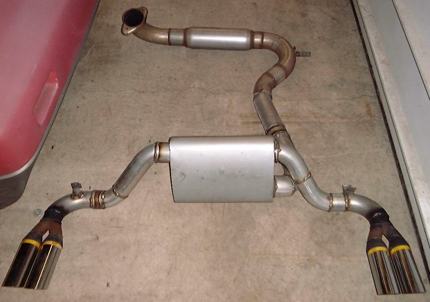

You could have one made like mine but it's a 3" and too big for a stock 3.4. 2.5" would be about right
All mandrel bent pipe, hooker tips and flowtech muffler.
85GT 3.4
14.9 @ 90 1.9 60" Old TH125/3.06

Well the parts cost about $100 for piping and $50 for one muffler. As you can see I have two mufflers and it's still not quiet. If you cut all your piping and have someone weld it, you'd save some money. You could use your old as a template. The Hooker tips are rather pricey, I took them off my old system, which was a 2". When I changed to a bigger pipe I gain almost a full sec. on my 1/4 mile time. Hope this helps
