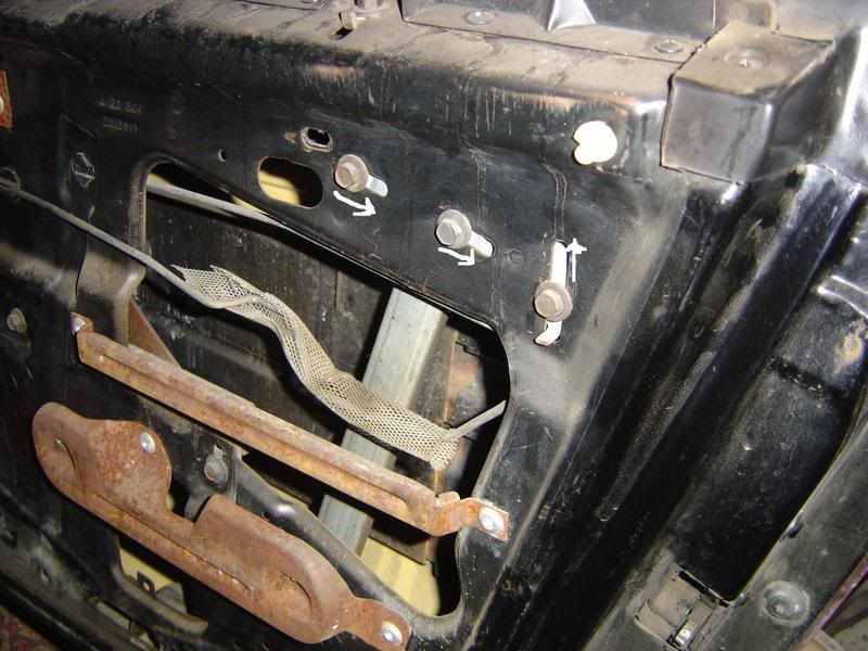

As either window goes up , just when it reaches the top, it should go in to seal up with the top of the door frame.
In the red fiero there is leaking when raining at the top.
Attached you will find door pics with arrows of adjustments i think would get the glass to move in at the top.
Please tell me if i am tight and when adjustments are required to be moved
Allen

i need to know if i move those bolts in the direction of the arrows wil it alter the angle of the glass when it reaches the top and fully exented [ meaning the window is them closed]

Set the height of the glass using the two "up-stop" adjustments (fore and aft). When you have the raised position correct, the top of the glass will "engage" the upper rubber molding when the door is closed.
